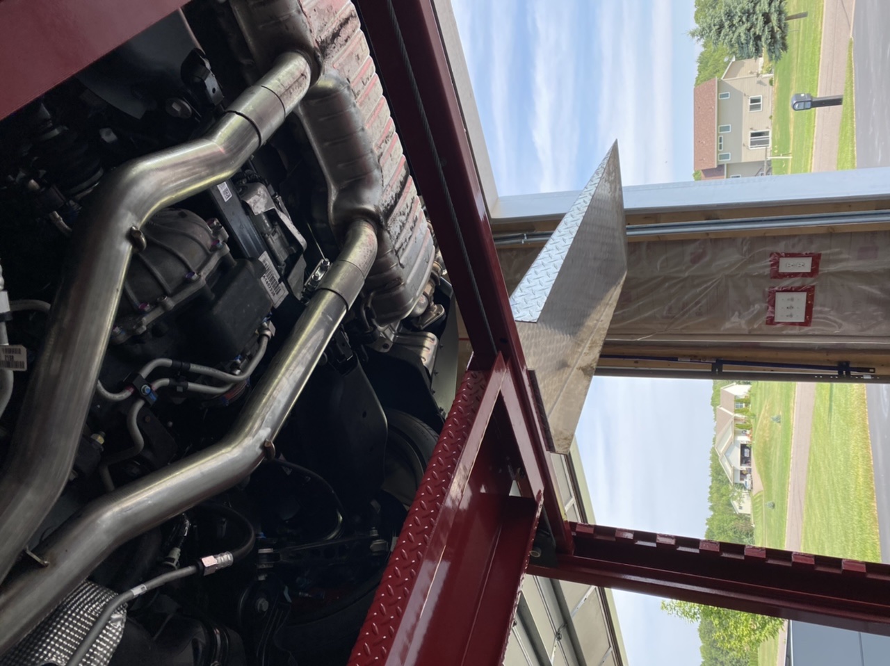

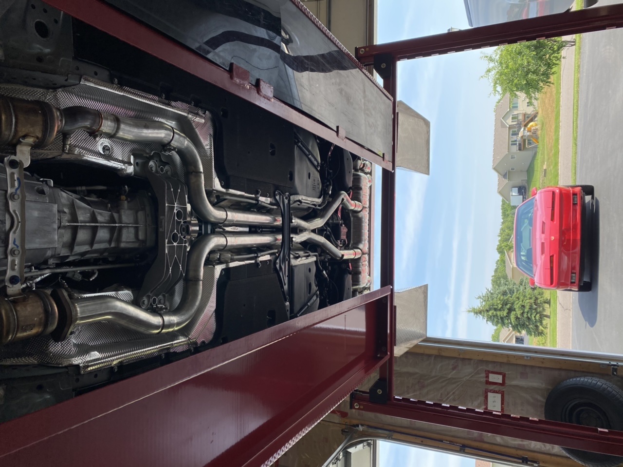

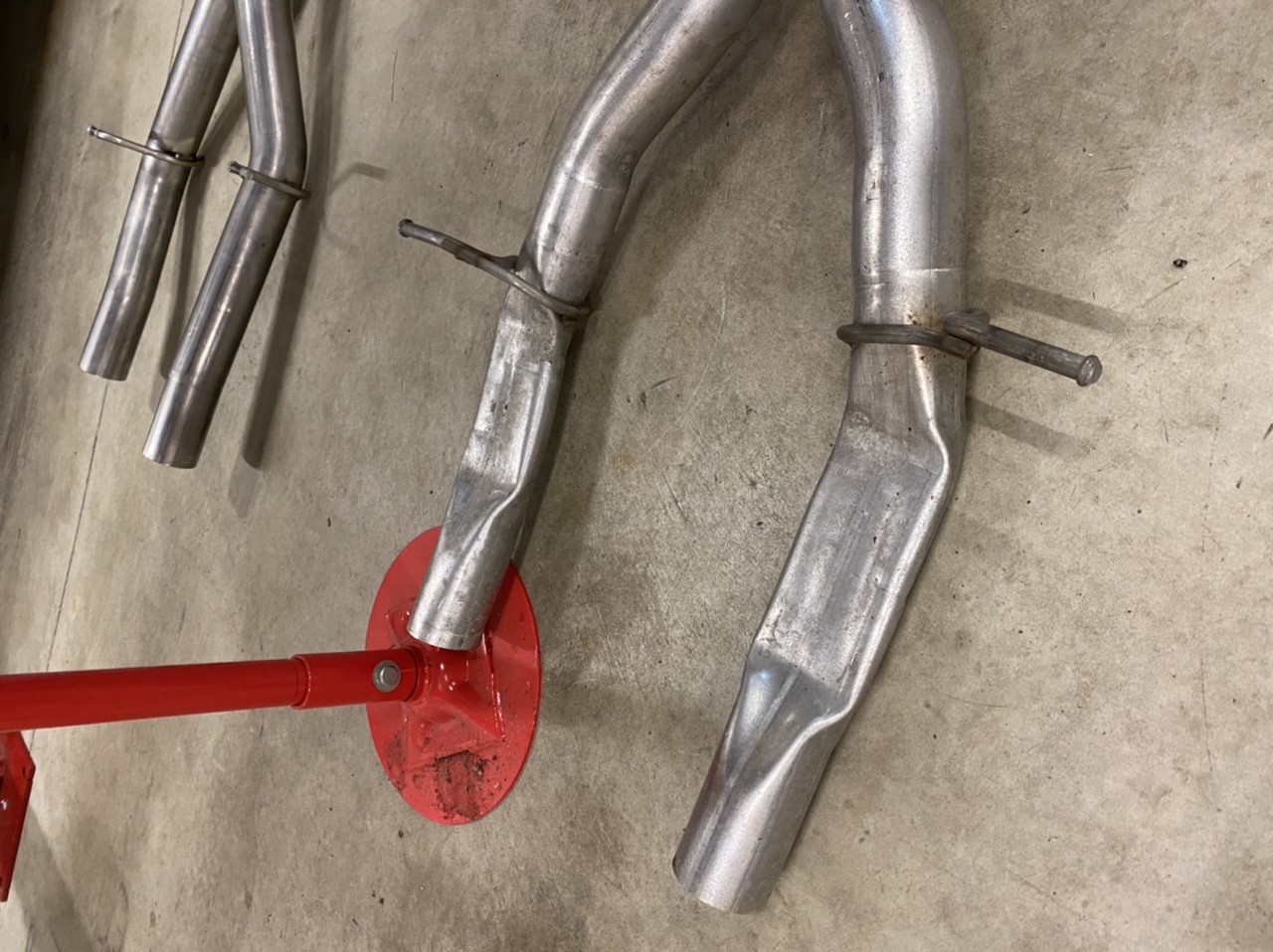

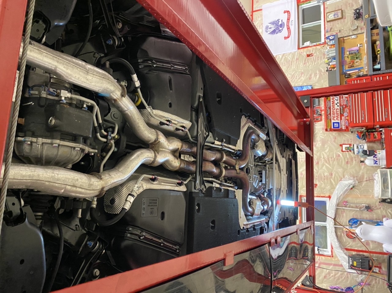

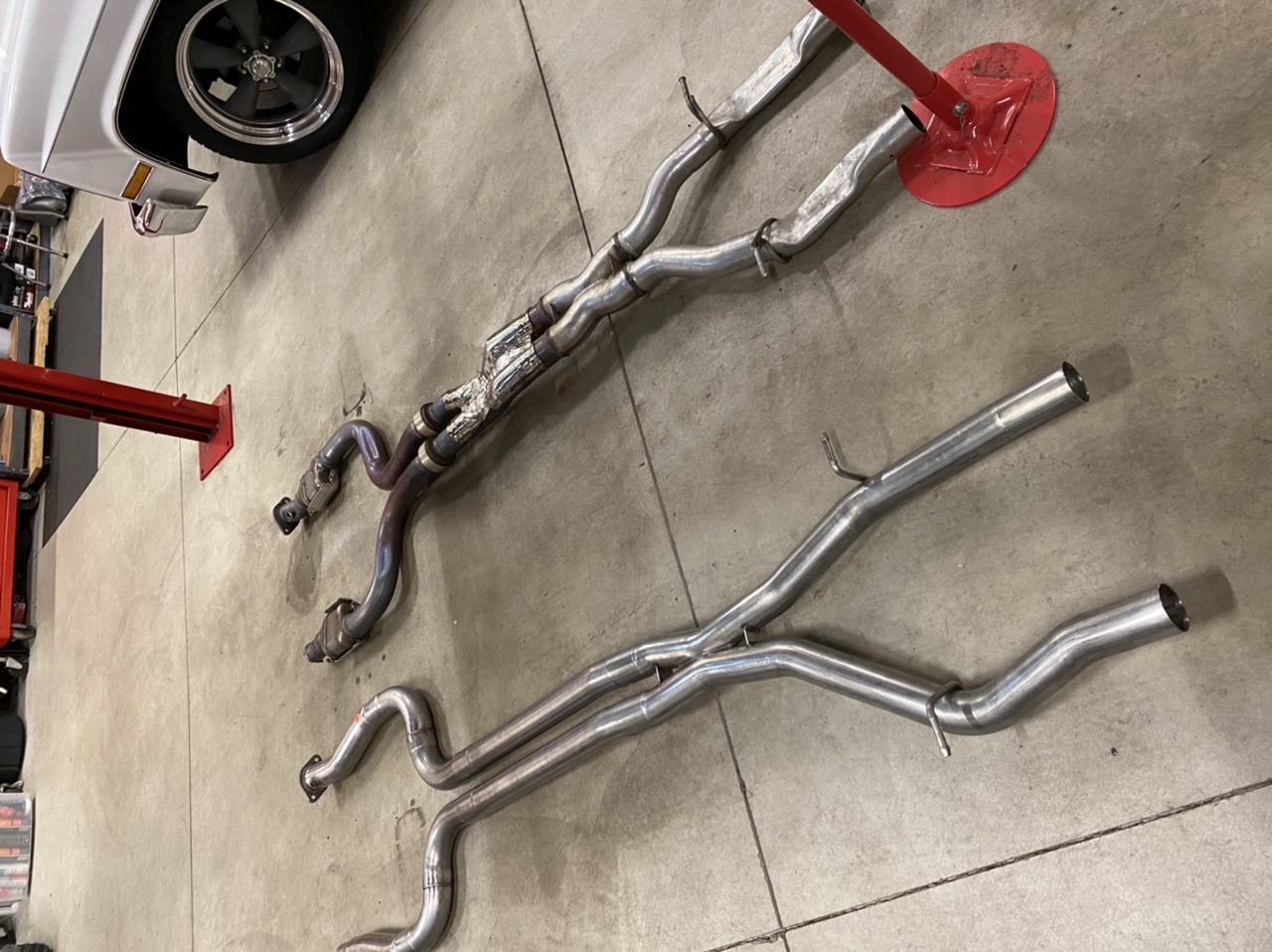

Added the Borla 60607 mid-pipe and AWE secondary cat delete pipes to my ZL1 recently. The crush sections just bother me too much (I did the Hooker pipes on my SS too) and I figured if I am going to fix that section, I might as well get rid of the secondary cats too and all the dips and dives of the OEM mid section.

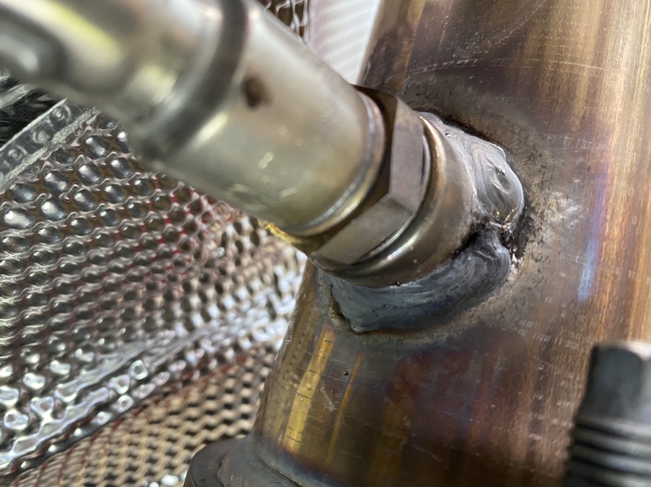

The only issue I ran into was the weld in the O2 bung of the RH AWE pipe was incomplete and caused a tiny leak and P0430 and P2098 codes. I have a welder and stainless wire, so only took a few minutes to fix. Although my weld is nowhere near as pretty as the AWE ones! (No pics of my hack job...)

Looks like a clean setup. Are you running any headers, or is that still stock with the suitcase? Curious how it sounds. Can you throw in a YouTube clip?

The OEM crushed pipes are horrendous. I still can’t believe Chevy puts those on these cars. Pathetic.

the crush pipes look terrible. How can this happen on the new 6th Gen ZL1? It almost seems criminal to see crushed sections of the exhaust ... Damm.

Thanks all. Sorry for the poor orientation on the pics. Not sure how to control that.
No headers, stock NPP suitcase. Didn’t weigh it, but I would agree that a very slight drop around 2-3lbs is about right.
Sound-wise, it is a bit raspier and slightly louder, maybe +10% overall. But not a massive change overall. Definitely no drone issues at any speed/load. In 6th at 70mph and the NPP valves closed it is hard to tell it is running over the normal road noise. Other mods are a Katech ported stock TB and the regular size dry Rotofab. I loved the way it sounded stock, and this is really just “more” of that sound, so definitely happy with it!

Yeah, I was looking at that but wanted to stick to a single X crossover near the stock location. I did some reading and people were saying the double X and a crossover closer to the engine will tend to mellow the sound out and I actually like the more crisp raspy sound, so I went the Borla route.

Yes, the Borla 60607 is 2.75” . I figured since I am keeping the rest stock, no need to jump up to 3”. At least for now .
