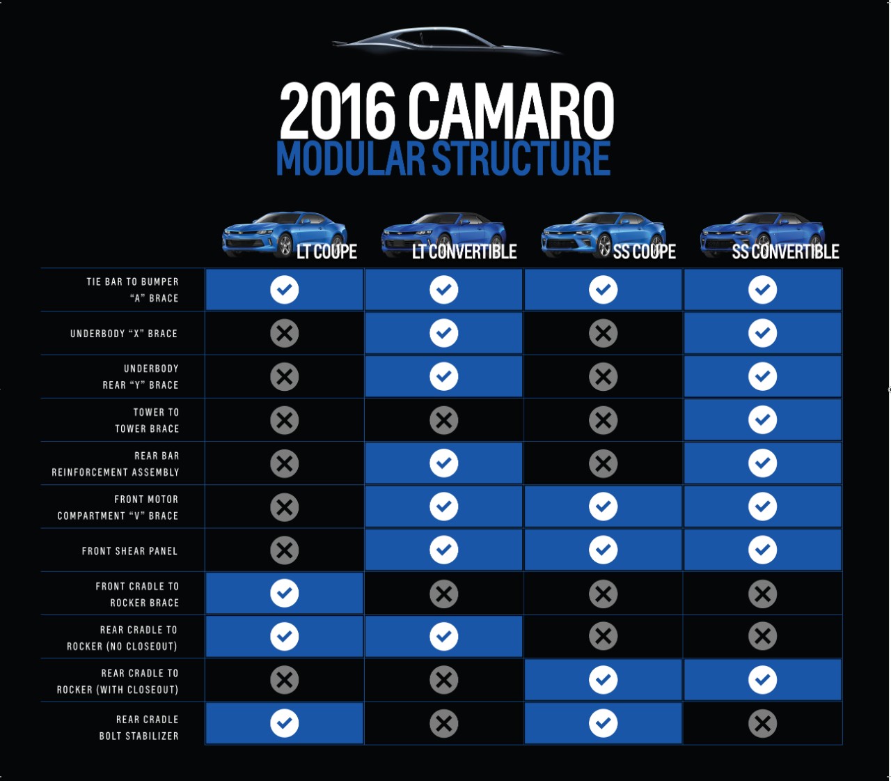

There's also different bracing on FE3 cars (compare the LT to the SS below). Other members here with V6 1LEs confirmed that their cars have at least the front shear panel added. FE2 LT cars do not. See https://www.camaro6.com/forums/showthread.php?t=561662
The FE3 suspension apparently benefits from a more rigid chassis. GM isn't going to add the extra cost of more and different bracing unless it really makes a difference.
Oh man, the price on that one piece though
Definetly adding it to my list of things I want but gonna have to recover from the FE3 suspension bits first lmaoo
Thank you so much!
