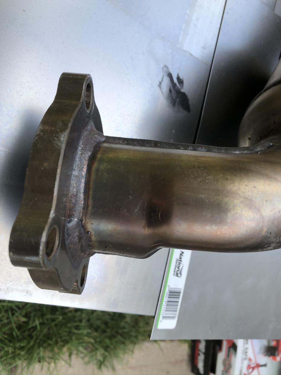

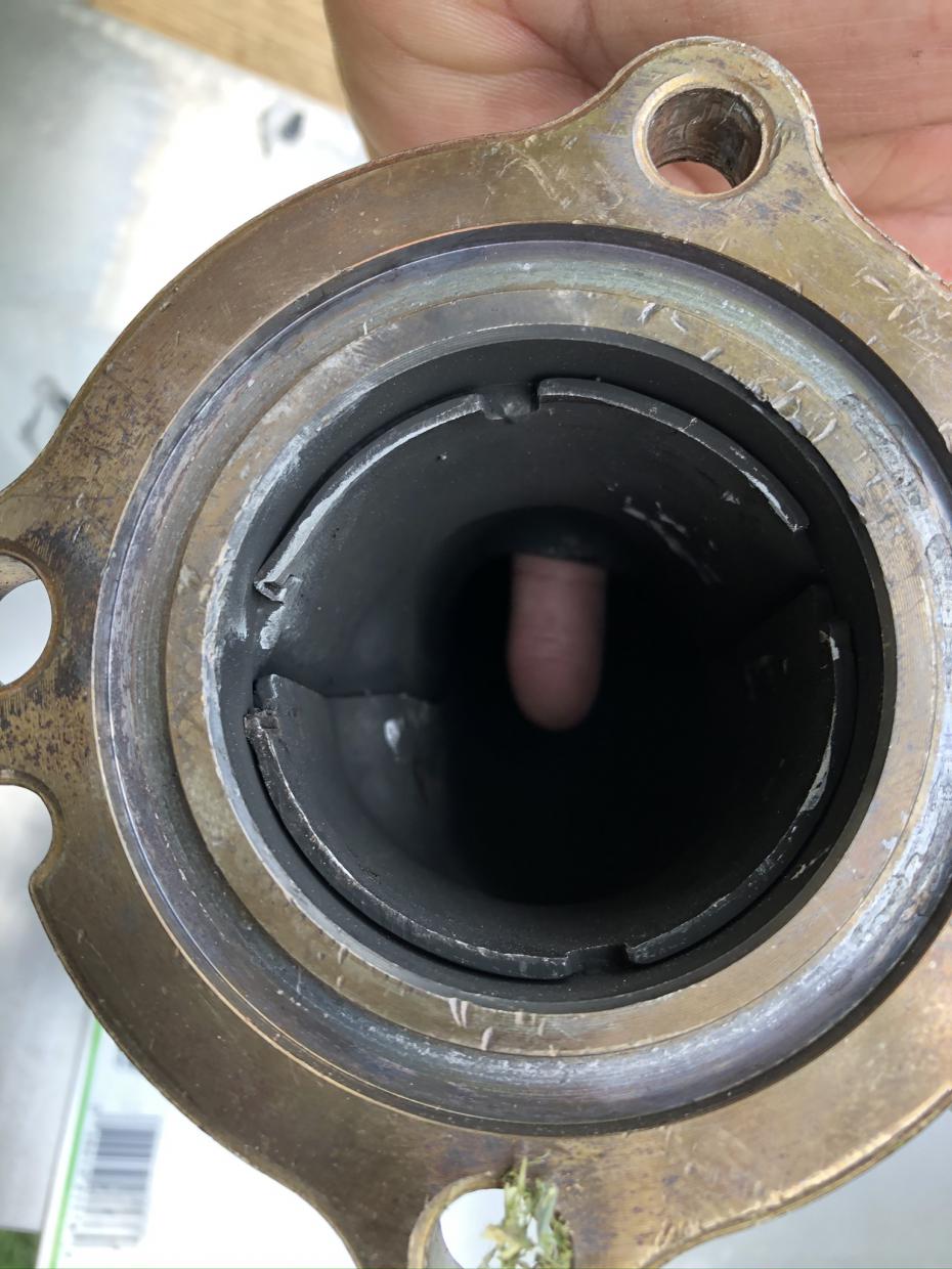

here is looking down the driver's cat:
1) the pipe suck in the cast flange is a major restriction and needs to be ground to a taper.
2) you can look down and see the 3/8 smash just before the 02.
3) The 02 boss is quite large and the the 02 itself can be spaced away. I may actually put my next mod into the the large round area just before the cat brick so there is nothing at the entrance of cat pipe (which is where most of the restriction is).
You can plainly see that 2 and 3 are additive in their effects on flow. i.e. 2 is just before the 02 which of course was on purpose probably to get flow velocity up to heat the 02 up faster.
I estimate:
1) pipe transition blocks 15% of the flow
2) smash bend 15 to 20% of the flow (2.1" ID ideal pipe)
3) 02 boss and 02 sensor blocks 15% of the total flow. Even CA cat delete pipes suffer from this one.

crush pipe before O2 driver's side. I section the pipe, expand and re-weld.

oldman: This is great stuff! Appreciate you posting the images - amazing 325 HP passes thru that restriction. Seems like small changes can return pretty good dividends for those sticking with the OEM parts.
