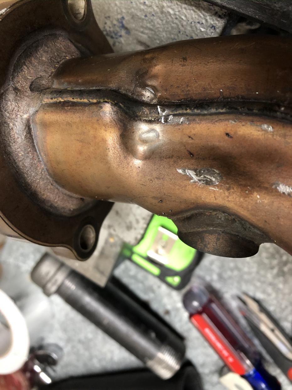

The stock front Cat is like 1.7 ID and it is a flat smash with an 02 sensor stuck in there and a bend, the second cat is 2.20 ID nice straight shot. It has been show on a dyno and on GTECH that the front cat delete is worth about 6 HP. So how is deleting a Cat that flows maybe 60% better and it a straight shot and is cooler to much cooler going to give 5 HP?
Here is my cat AFTER I cut it open and widen it. Have not ground away the 02 bung and I space the 02 pretty far out of the stream.
