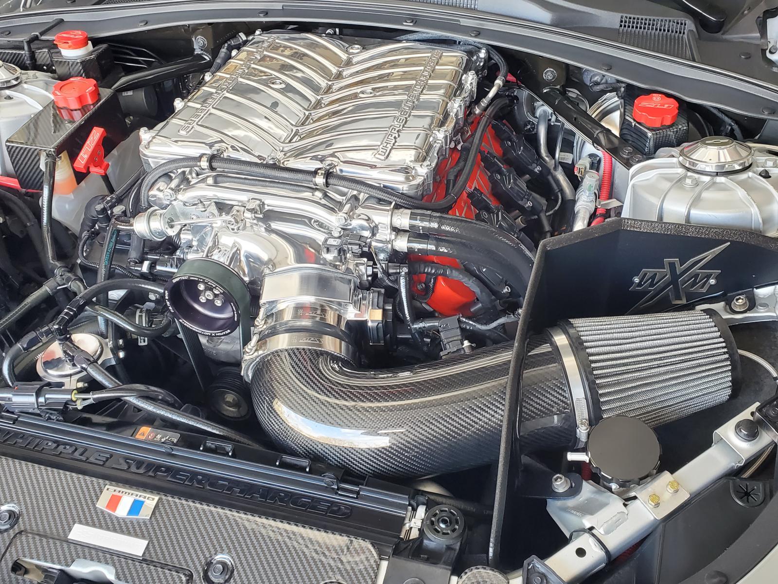

I have the Weapon-X Boost Freeze Chiller on my 2018 Daily Driver.
Almost 2 yrs and 24k miles of continuous use. I use the AC for the blower all Winter also.
Mine was the very first production unit, we first used it on the stock blower with every Weapon-X package...then it was rolled over to the Whipple build.
It does delete the small Driver side HX, but I have the WX HX for the other 2.
Best money that I spent so far...it works like a charm!

This is an absolutely amazing engine bay, congrats

So you still use the passenger side hx which I believe it's for engine cooling and you change the stock center hx for the WX -HX. So you only remove the oem small driver side HX?
