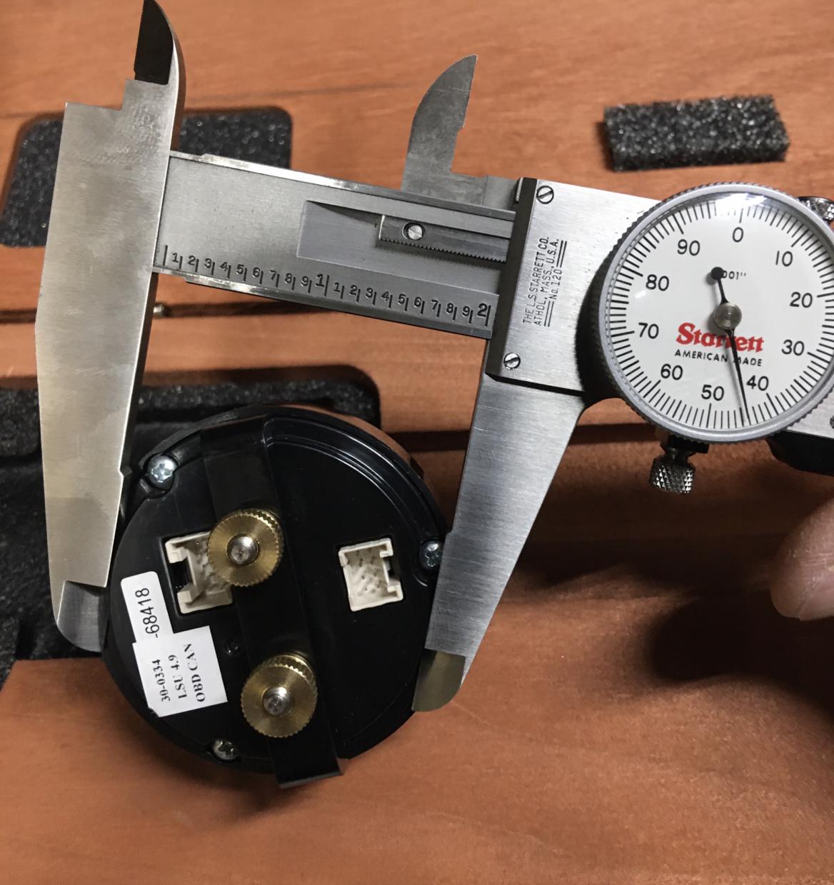

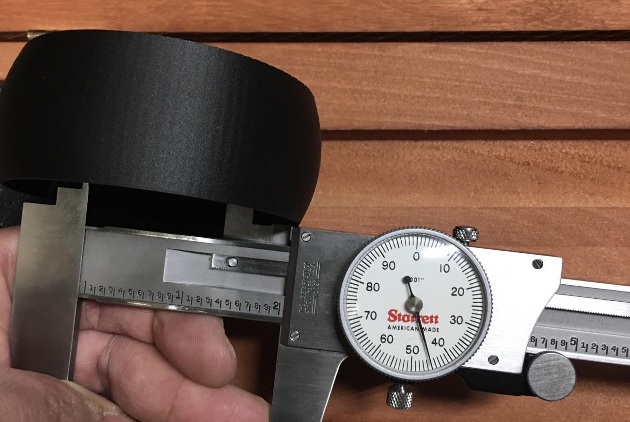

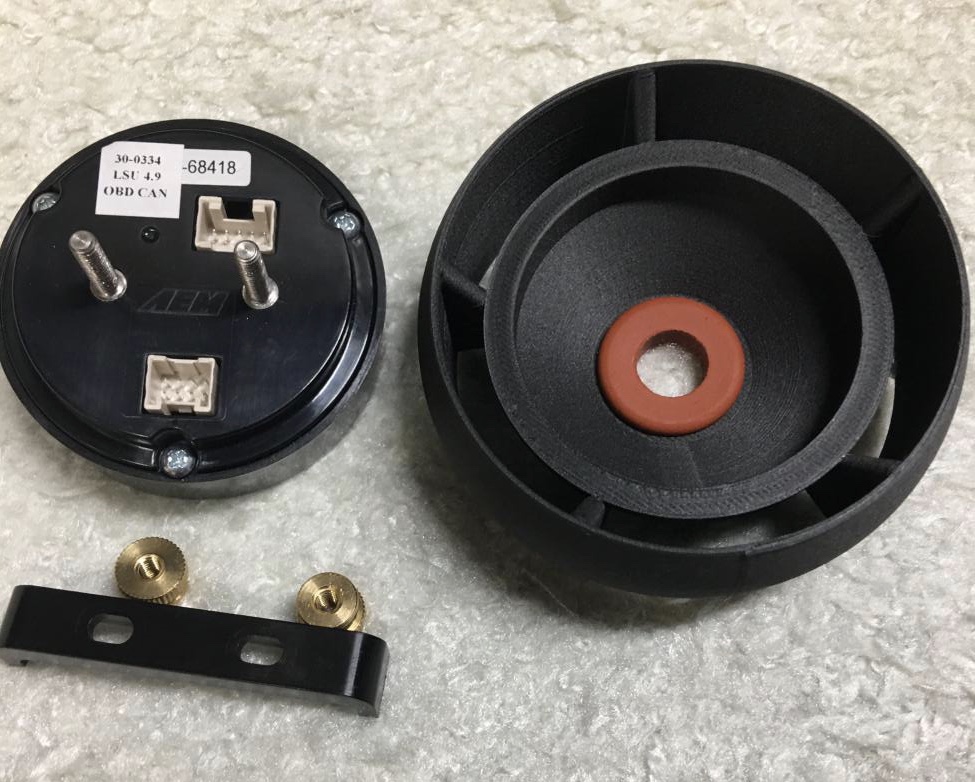

While I haven’t compiled everything I want to actually do the install, I do have some input.
First thing to notice is the PEM’s in my AEM 30-0334 are not long enough to protrude throw the part purchased from member CNC. This doesn’t mean it won’t work, just not as plug and play as expected. That means the gauge bracket won’t clamp against the back of the pod. The gauge has a 1.044” diameter where it slides inside the 1.044” bore diameter of the pod. At best it’s a slip fit.
Second issue is the wires that leave the back of the gauge are very tight being routed into the center grommet of the pod. Again not a big deal but not plug and play.
My solution to all of this will be to extend the PEM’s so the bracket from the AEM gauge can be utilized. Lastly I’ll add a drilled holes in the pod and grommet them for the wires.

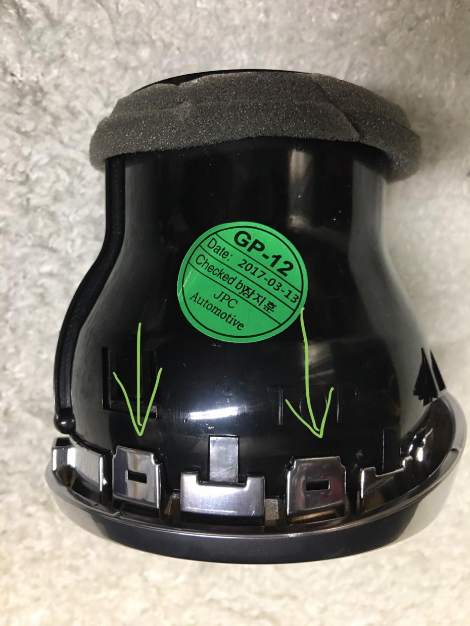

So I looked at the vent I pulled after installing P3. I tried with 3 trim removal tools to lift the chrome area in the picture over the black plastic bosses. SOB the chrome area keeps engaging as I’m going around the ring. There are 6 of those chrome tabs.
There’s no doubt once the chrome ring is off, the internal diffuser portion will come out.
The vent pod will go in the cavity and the chrome ring will hold it all in place.

So run the wires out where the little foam ring is on the pod?
