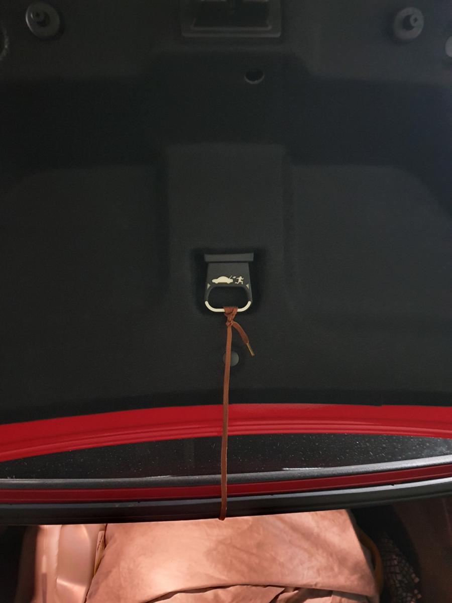

I posted it on another thread, but I post it here as well for future reference.
I had to disconnect the battery on my ZL1 because I was leaving for a trip. So I tied a cord on the emergency latch pull inside the trunk, I dropped the rear seats (yes, they drop in the ZL1) and when I return, all I have to do is simply pull the cord to open the trunk.

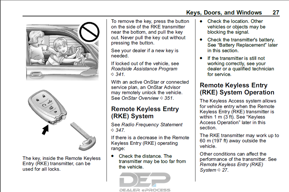

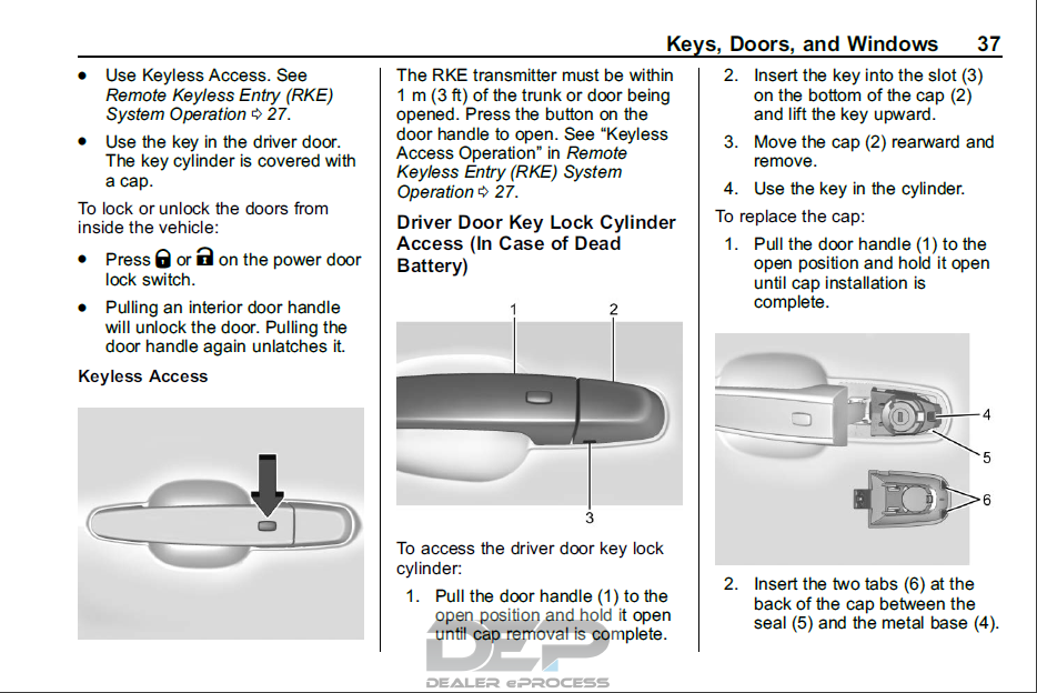

There is a key in your fob. There is also a trim piece on the drivers door handle that is removable and will expose a keyed lock.
Remove the trim piece and use the key from the fob to unlock the driver's door.
