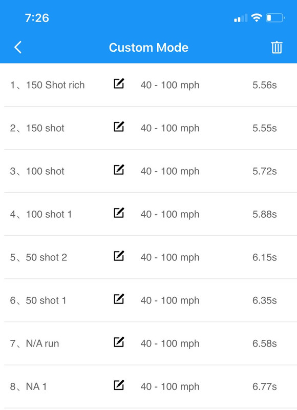

UPDATE: Installed Full Nitrous Set Up and Did First Test Hits!
UPDATE #1: Wiring Diagram posted below in original post for reference
UPDATE #2: Nitrous Kit is installed and below are all the YouTube Videos on How I installed it along with Testing
UPDATE #3: Did my first test hits on the Nitrous! See image below of the Draggy time comparisons from NA, 50, 100, 150(rich afr)
going from a 4th gear 40-100mph run starting at 38mph on each.
