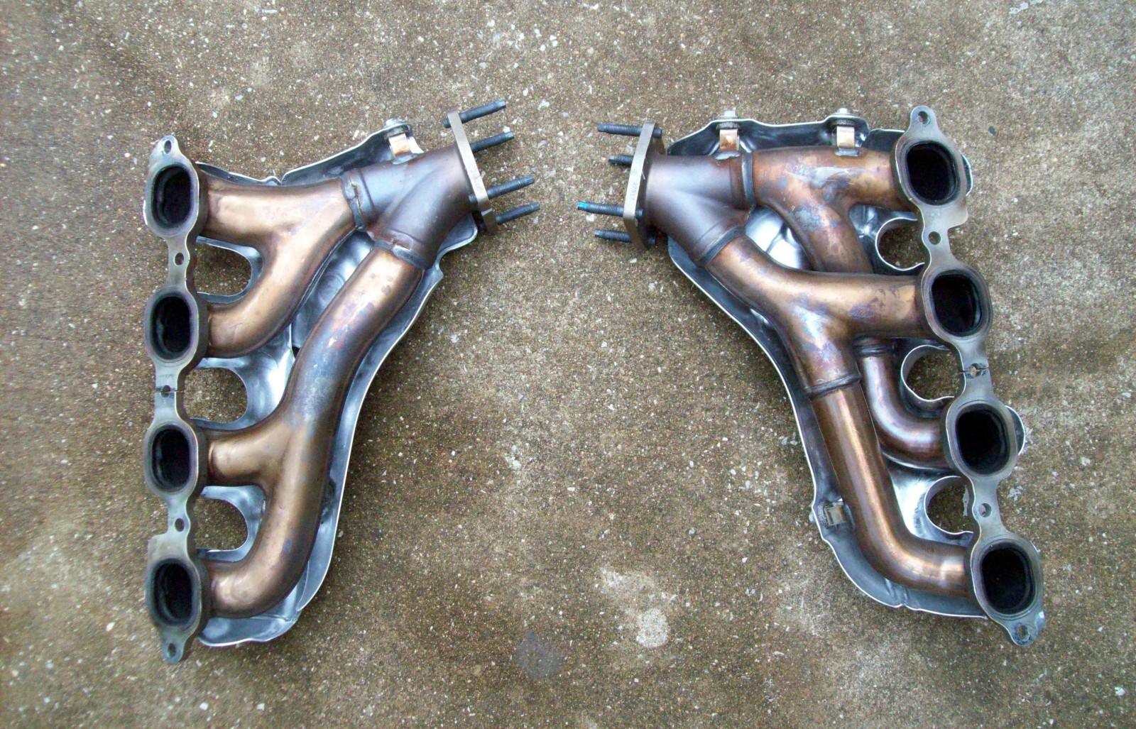

Waste of time. You have Tri-y manifolds OEM.
There are photos online.

Here is a pic. Your not going to gain much with shorties. Its LT or OEM being your best choices for the money and time spent.

The SS already comes with Shorty Headers. Underneath those heat shields lie Shorty Headers.

Stock Headers....
https://www.ebay.com/i/124058799707?...yABEgLhYfD_BwE
Click on the manifolds.
