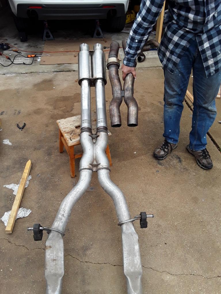

So today CA offroad pipes, factory headers and the 60608 installed inback of the 2nd cats... results are surprisingly quiet and really no it truly behaves like stock. A surprise because to be honest in general short large diameter resonators don't do much, balance this out that the per piece Borla stuff are 2 and 3/4 (there systems are all 3"). So yup actually works.
So this probably concludes my quest after like 20 tries for a quite system that flows well and that has a high RPM engine sound vs just loud.
stocker headers, CA front cat deletes, move rear 02 to behind factory 2nd cats, factory 2nd cats, Borla 60608, and then stock exhaust back.
Oh, BTW, my ancient Lisle exhaust expander broke 10 years ago or so, I tried two lifetime expanders and they broke first use. I got a lisle (pronounced lyle) and it can actually take a impact gut and it expanded the pipe like butter on a hot cake.
Here it is:

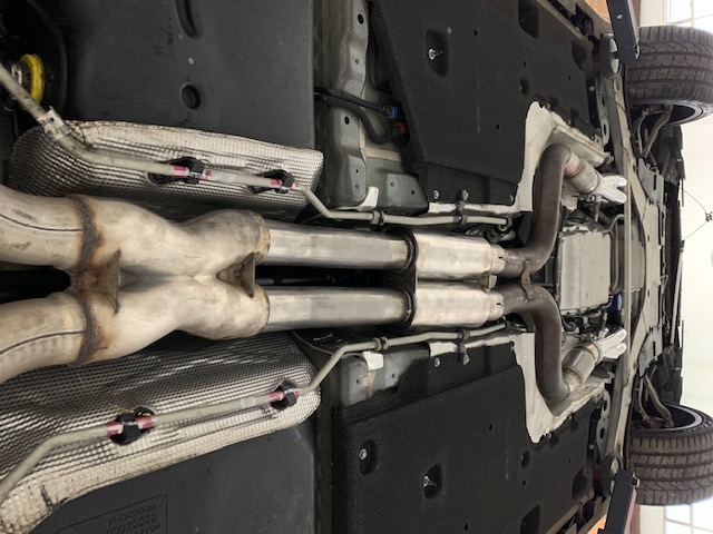

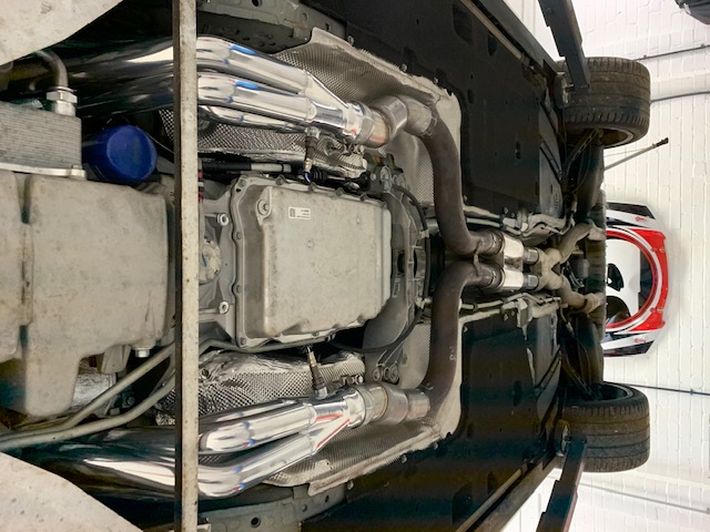

Heehee, great minds!

Looks like you are running the bone stock x pipe back, your sig says de-cat, but they look like cats. I'd like to know your overall impression on an auto LT4 before and after the setup and why you went to the twin resonators?
Secondary cats are hollow & welded back up, done before I started modding.
Why double resonators? Have you heard a fully de-catted system running into a stock suitcase?
roger that, IMO it is even worse with the M6
