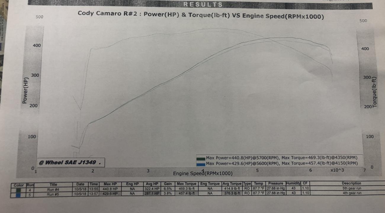

This is the first results of tune after install of parts listed below. Performed 1 year ago
Previously car made 440hp and 469torque (on E85) about 1 year ago, 30,000 miles ago

you still on stock manifolds and cats? if so those are very good gains. Where is the leak? as long as its more than 18" (i believe) downstream it won't make a difference.

Never seen a msd follow the same curve as the stocker. Maybe the leak is effecting things and it’s not retarding the cam. The big jump at 3700 rpm never happened. Have any logs?

No Stock Manifold, No Cats, First image of what car made originally 1 year ago, 2nd image down is what its making now after installing additonally, MSD ported intake, Rotofab and LT5 TB. Leak is driver side header where it meets the block.
Sorry no logs in hand

is that the side the tuner put the o2 sensor on. if so he couldn't tune it. and the cars not going to run right. you cant have any leakes befor the o2 or 18" behind the o2. if he used the pass side for the o2 then fix your leak and reset the fuel trims because the drivers side is off. Your tuner shouldnt have tuned with that leak.
