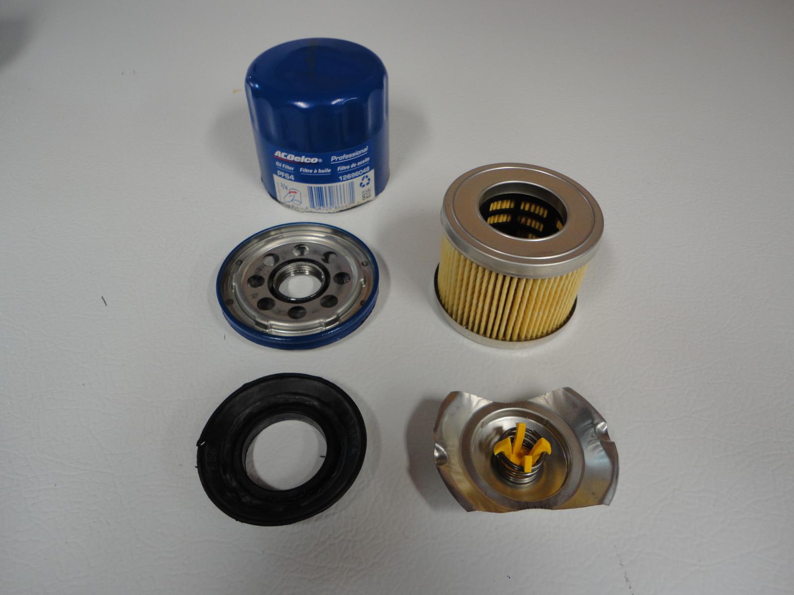

For the Gen6 Camaros with the LT1/LT4. Some of this has been previously covered:

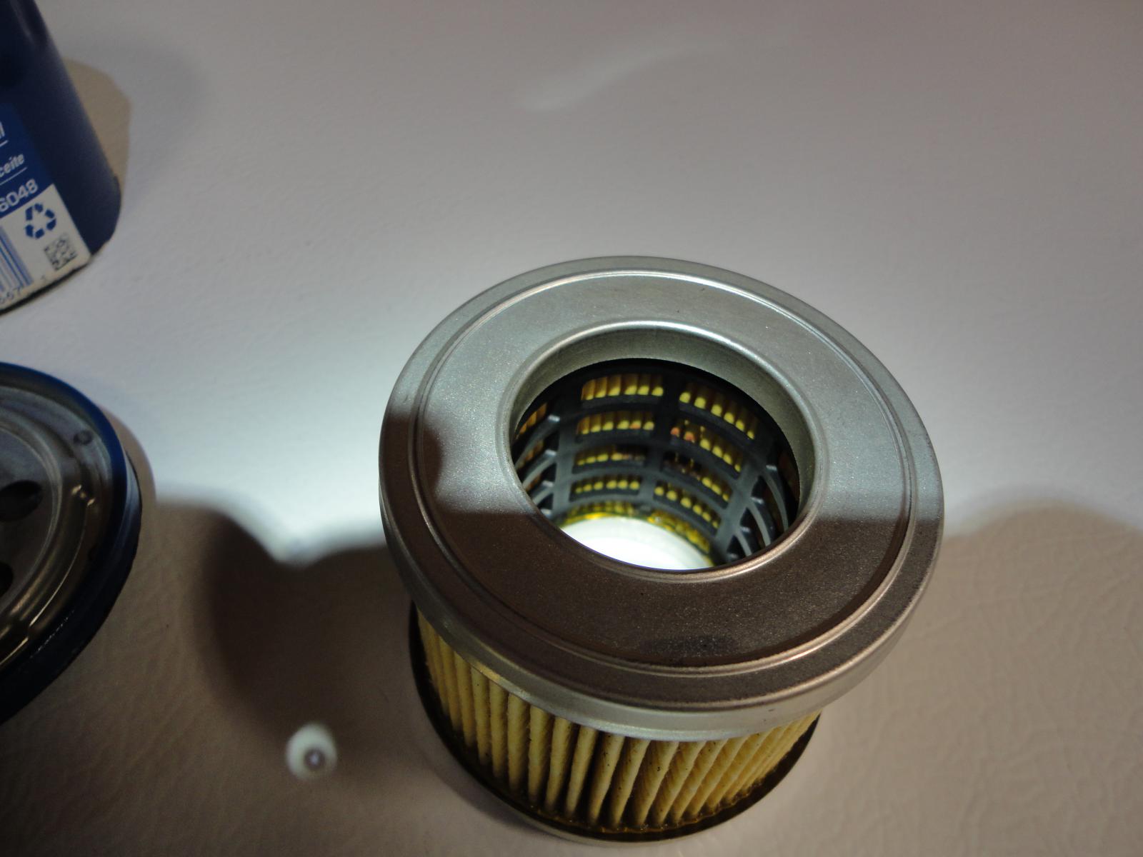

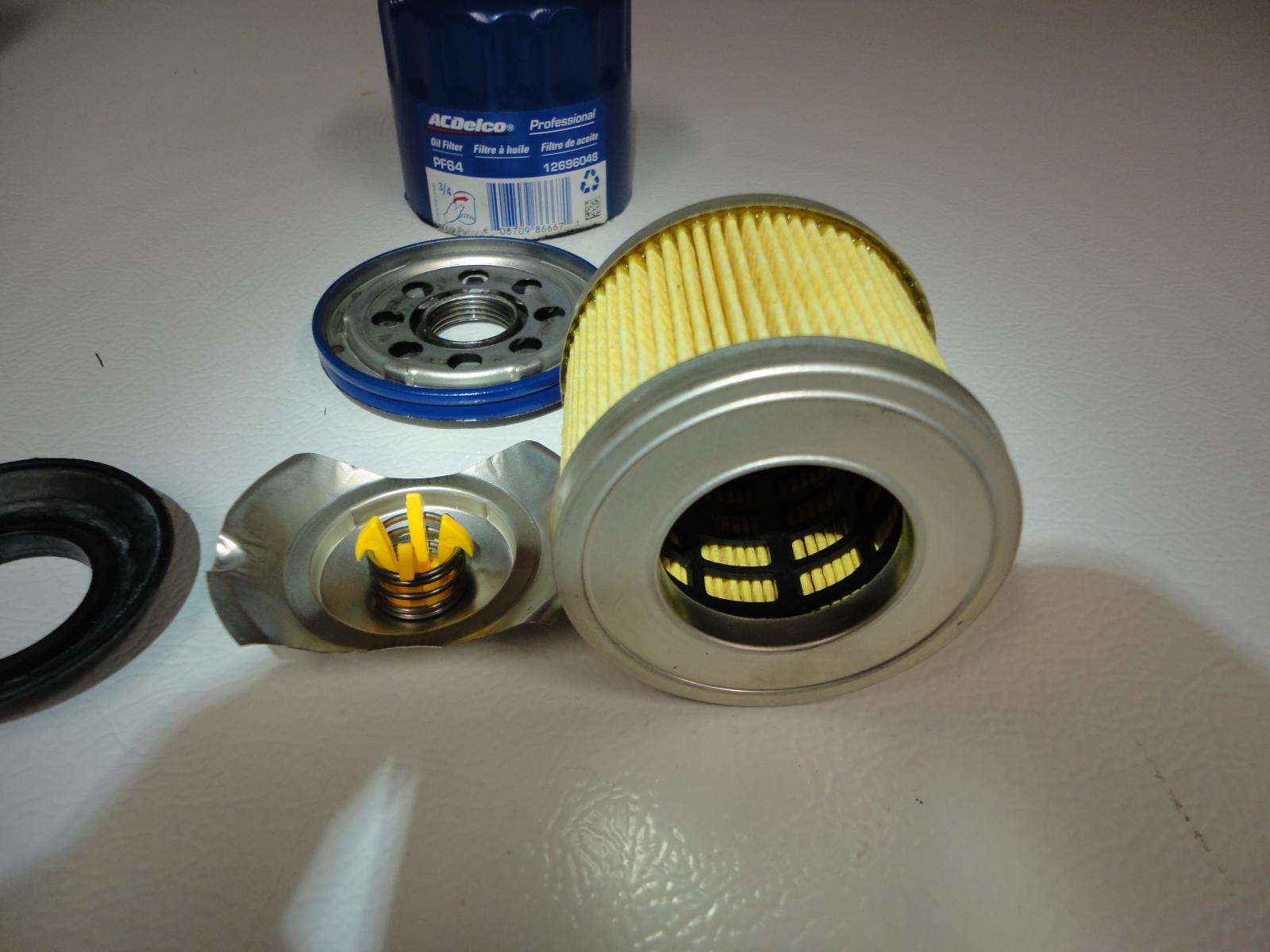

I cut apart the newer version of the AC Delco PF64 Oil Filter, GM part # 12696048. There is an older version of the PF64, part # 12640445, but it is going to be harder to find. Some people thought the older version was a better filter.
Overall the newer PF64 looks OK, it does not have the paper/fiber end caps of some of the GM/AC Delco "E" core filters. It also has a bypass valve with a coil spring. The bypass valve set point is 22psi. GM states the proper filter with the correct bypass is critical for the Gen 6 Camaro V8s.
But....
It is a touch shorter.
It has a plastic inner retainer.
Realistically, I see no problem running this filter. Some may want to run this to satisfy the warranty. Are there better filters? Certainly.

Good information here and as I suspected when looking at the newer "048" part.
This is why I quickly stocked up on the good old "445" - Seems to be built a lot sturdier overall.

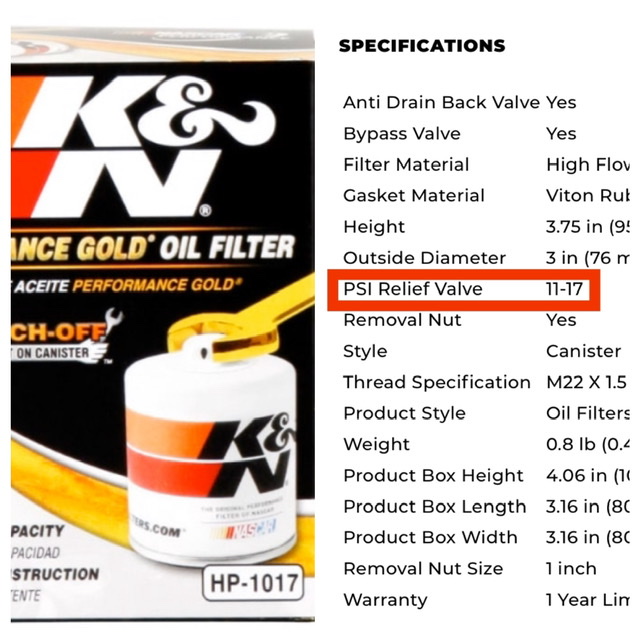

I bought a K&N oil filter just to have an extra one on hand, and now that I’m looking at the K&N PSI relief valve rating, it’s rated between 11-17psi.
... I guess I’ll be returning it?
