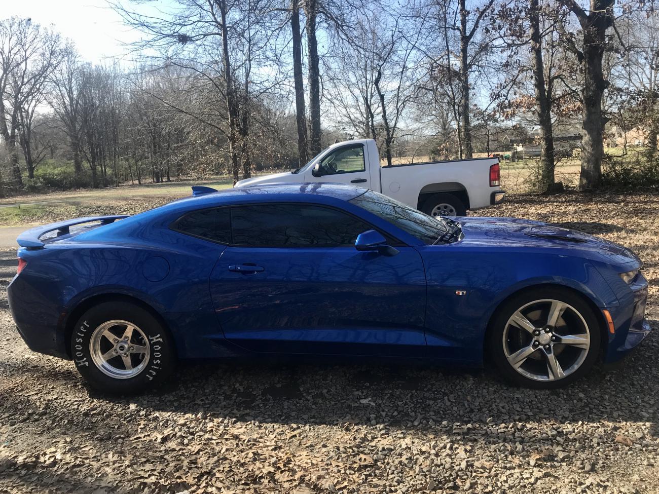

I just finished my 15” conversion that I pieced together. The answer to your question is yes and no. I used a set of v6 rotors combined with 2016 ATS calipers. The calipers will require some grinding for clearance with the amount of grinding depending on wheel choice. Aftermarket toe arms will be required as well. Along with this you will need banjo bolts to fit the calipers to the factory lines. BMR toe arms, modified Cadillac ATS calipers, v6 rotors 12.4” diameter, jegs ssr vision 15x8” wheels, and hoosier 15x27x10.5 qtp’s.
