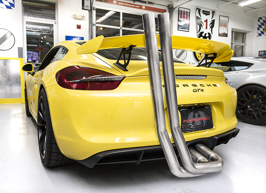

Some of the "Laguna Pipes" look like they are over the top just to make a statement.

haha you mean like these? bozo bro!
