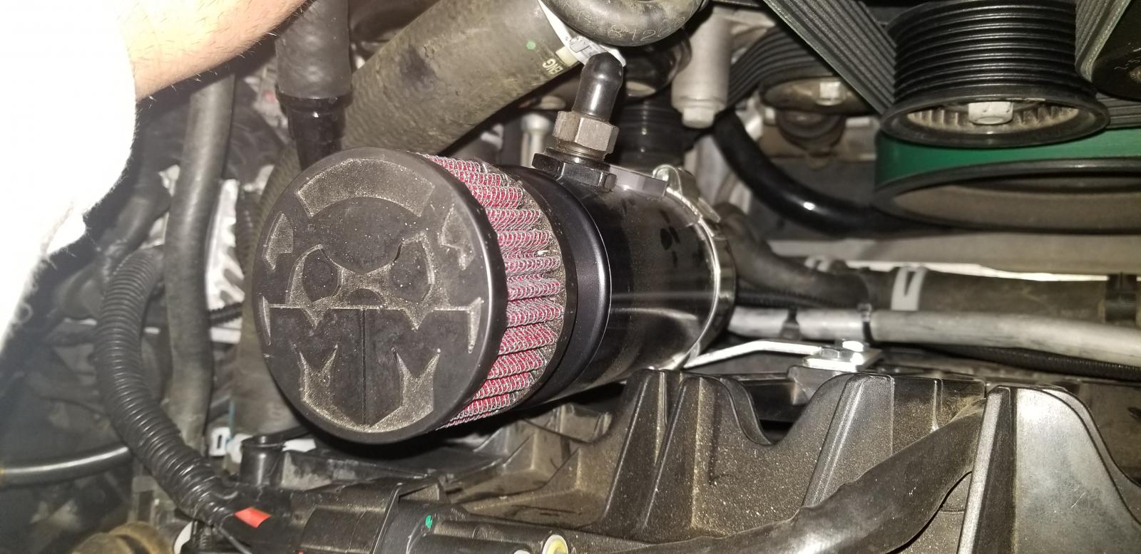

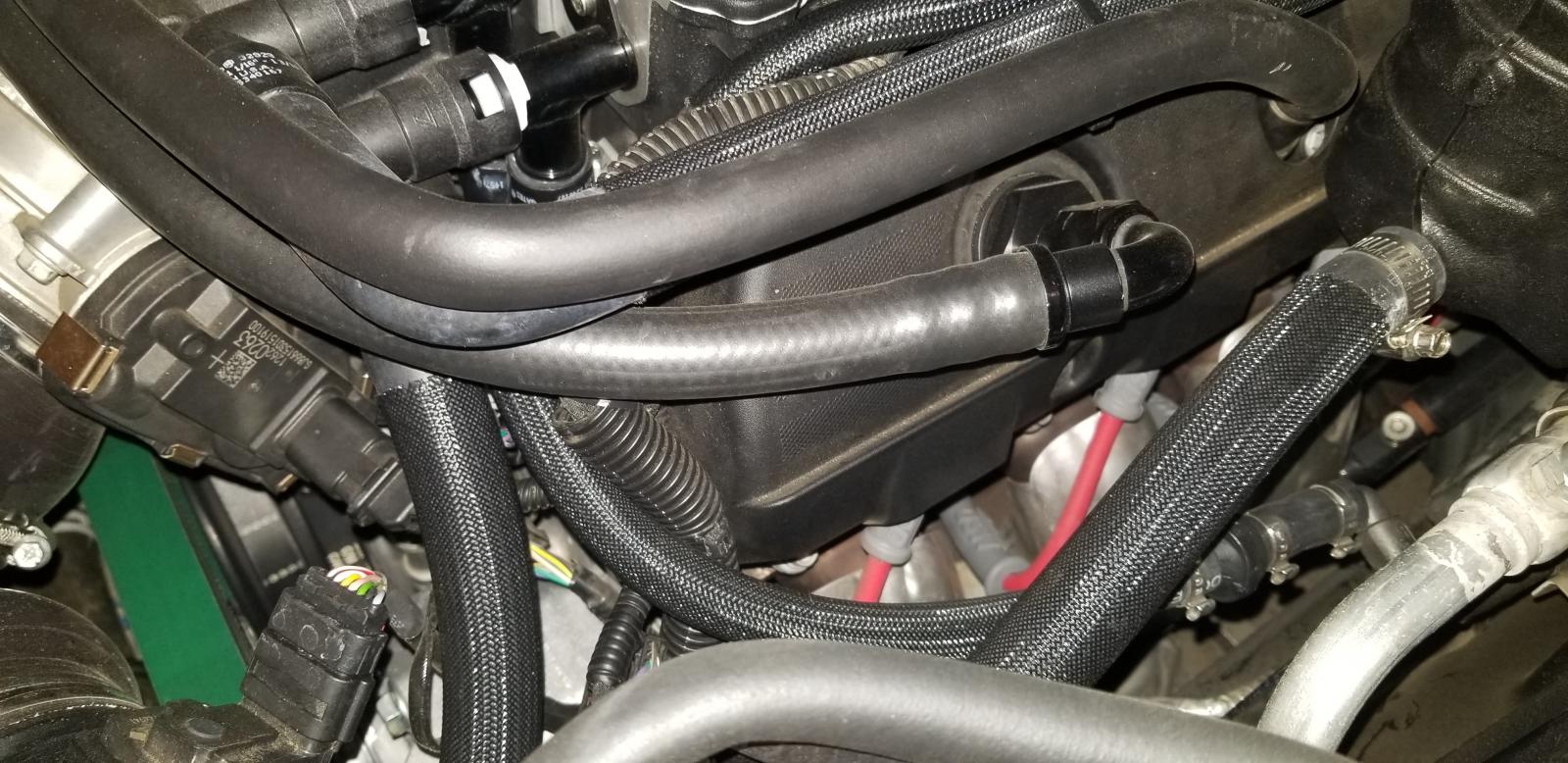

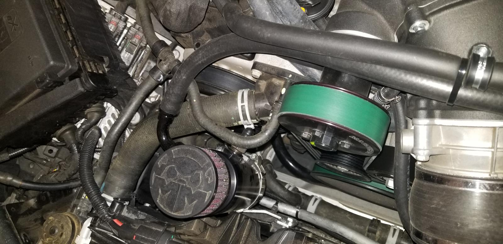

So recently I had a Maggie installed and ordered a Mighty Mouse Extreme Catch Can. I noticed last night that one fitting was capped (PCV) and the other was simply connected to my driver side valve cover. I really questioned this and reached out to MM. Their response is below. Sounds like I just need to find a PCV return and be good to go. Easy enough I suppose. Can someone guide me here?
here's the install doc for the camaro 6 wild https://docs.google.com/document/d/1...7PH6uU8h_n2U8I
the pcv valve is what is capped, this should have connected to intake manifold vacuum. you should ask why this was not done.
-without it you are full venting no pcv filtration or fumes control
In my defense I was capable to install a full Procharger system on my C7 but I cant connect a fricking catch can. HAHAHA

The clean side of this MM Catch can is blocked off. That should be connected to a vacuum source from the intake. I've never set one of these up on a Magnuson supercharger before. Is there a good vacuum source built into these? Once you locate that just Tee off of that source and over to the Catch can where its plugged and you should be all set!
That is the only thing needed. The Valve cover fitting to the can is your dirty side and connected correctly.
