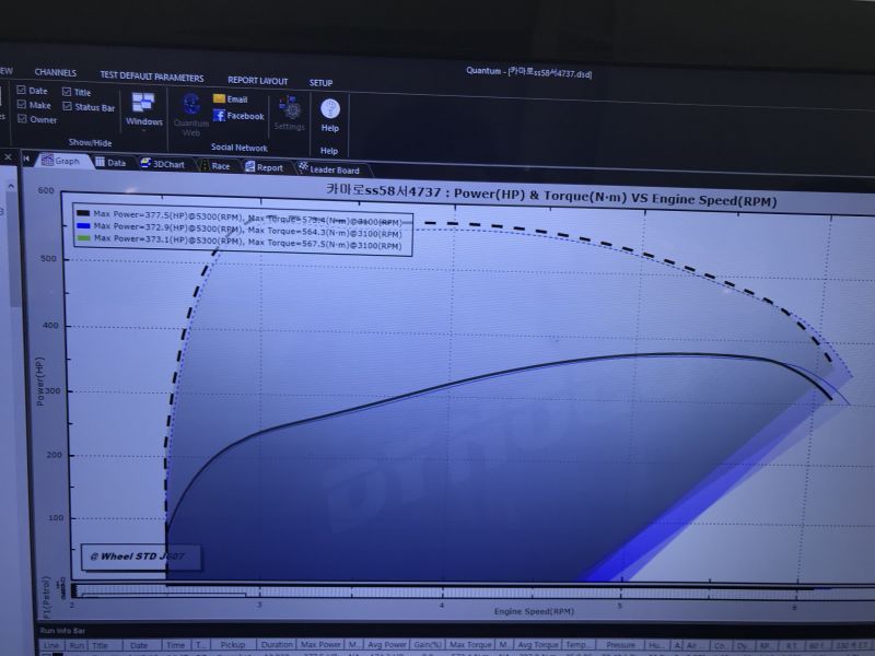

At first , he ran a dyno before supercharged and the result was
370rwhp. Little bit lower than the average, but ok.

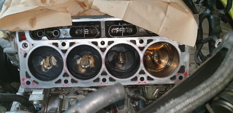

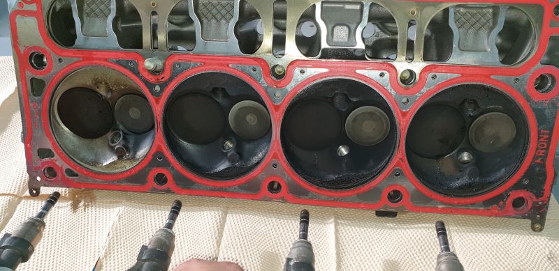

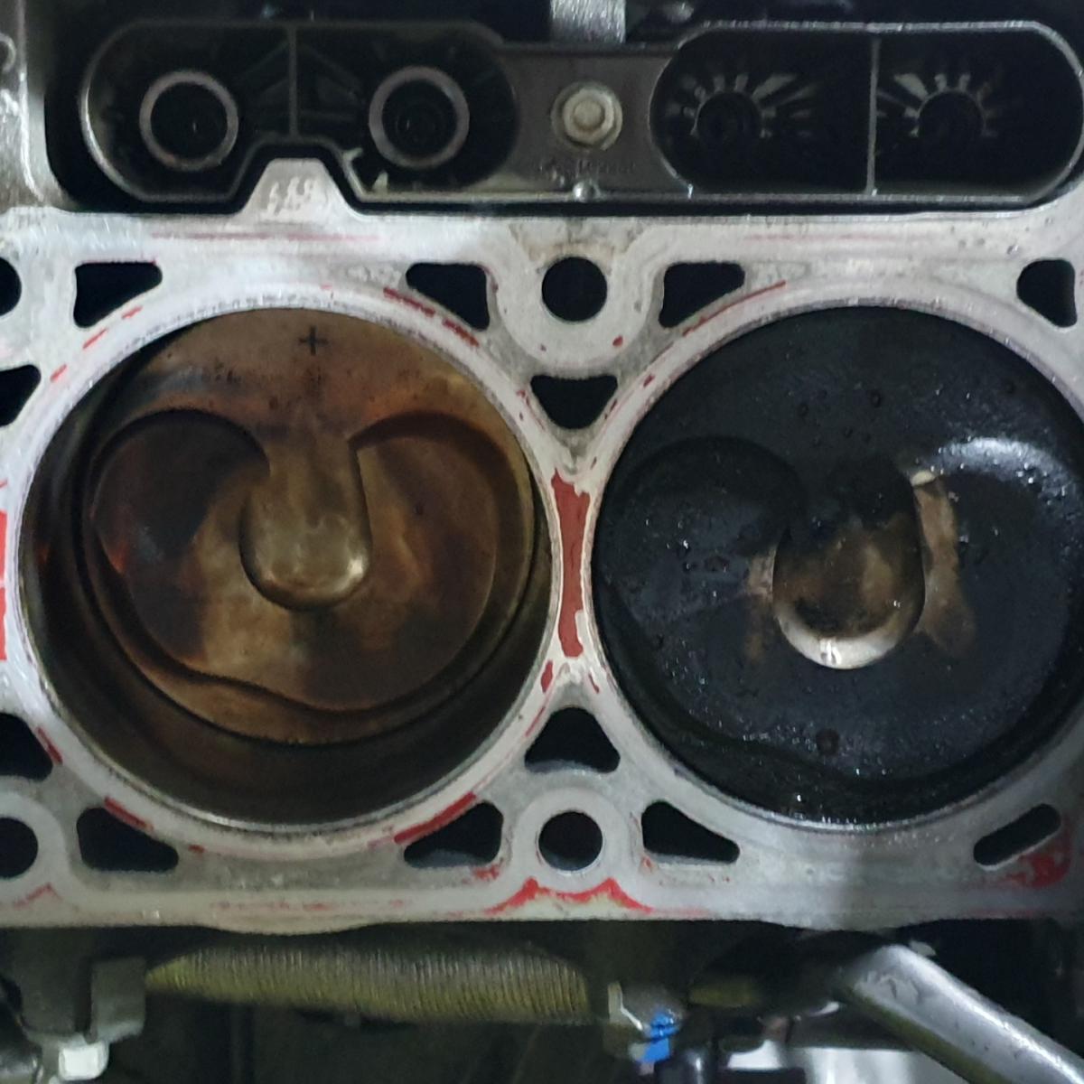

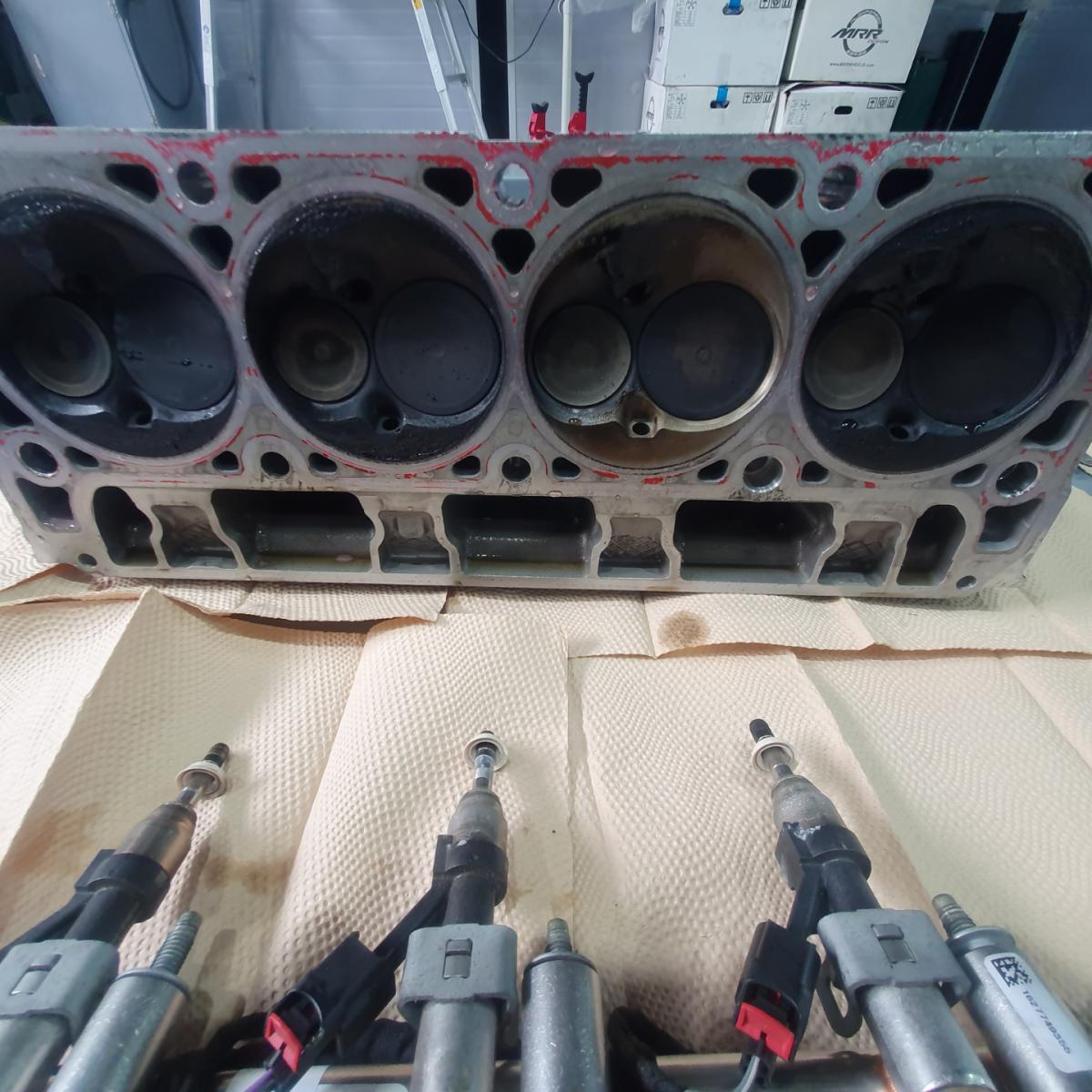

And his car passed the leakdown test , then supercharged, but felt something wrong.
So we decided to open the engine and...
The mileage is around 25000 mi , and 2 pistons are super clean. :(
I am not sure how he drove the car without any notice.

Headgasket leak?
