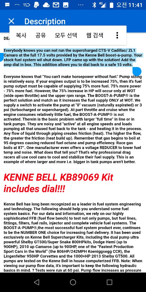

I am using a BAP from JMS, but recently I saw the below
What is this meaning?
17.5 voltage which I am using is dangerous to my system? F35 Fuse? Or the fuel pump itself?

Fuel pump itself, I have a JMS box and found this out recently. I bought it up to JMS and they said they hadnt heard of any issues. With in 3 months of adding the JMS to my system my LPFP was burnt up and I had to replace it, lucky it was under warranty,
As soon as the new pump was in the car I backed the JMS back down to 16.2v and then I put the fuel pump voltage in the tune to the 15.7v that the ZL1 uses. So far no issues, low pressure side on my logs holds over 70psi all the way up to E55 with no issues. Now if I could just get my high side to keep up, thats a whole nother problem.

Oh, thank you for the info. I need to lower the voltage.
