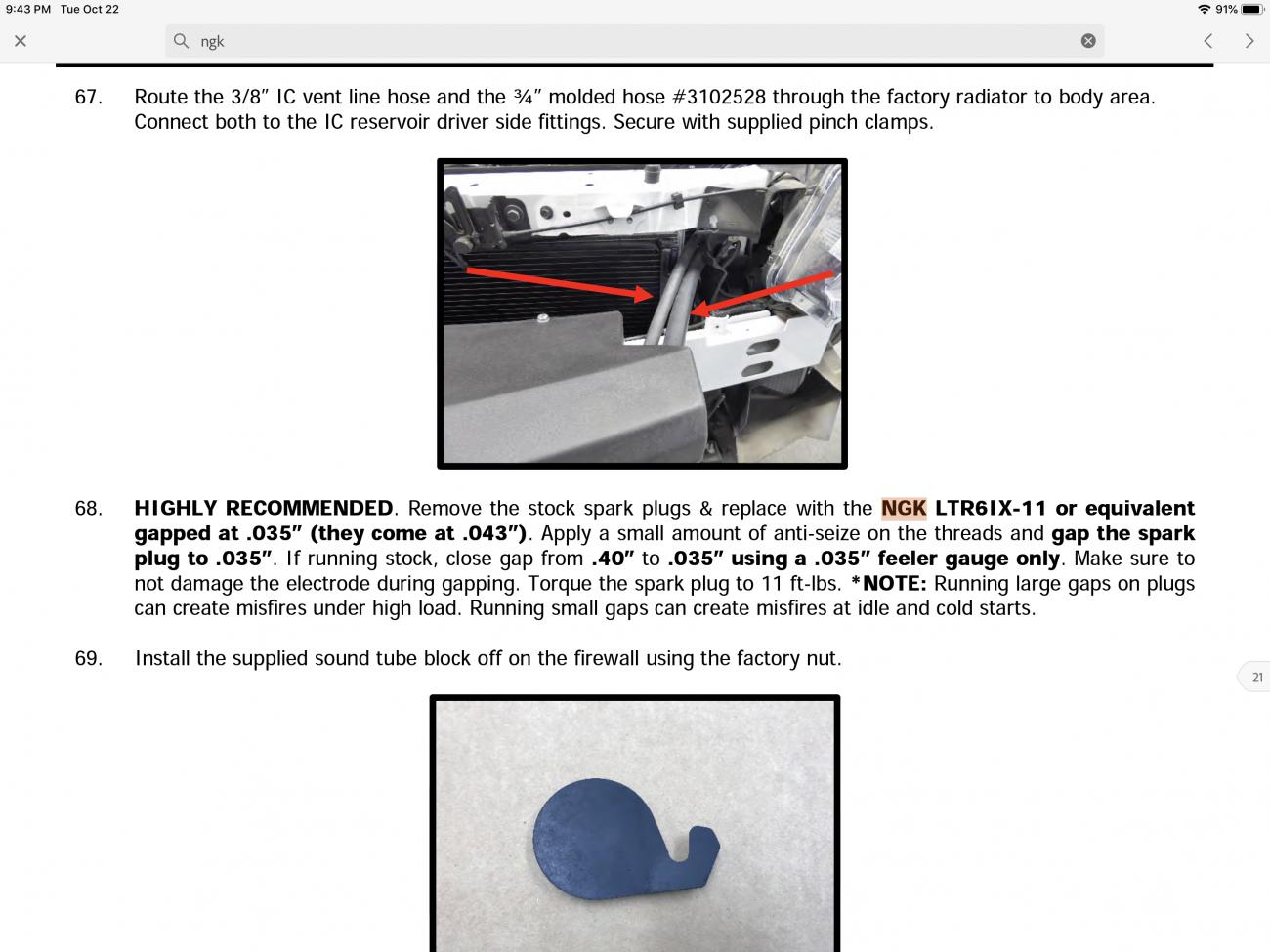

Whipple highly suggested a change to NGK LTR6IX-11 with the gap set to .035”, so that what’s I did. No misfires at all, but I’m also not pushing the blower very hard (yet).
