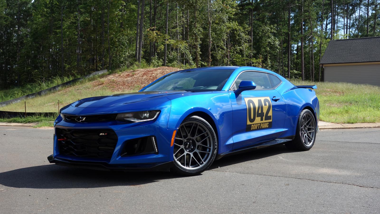

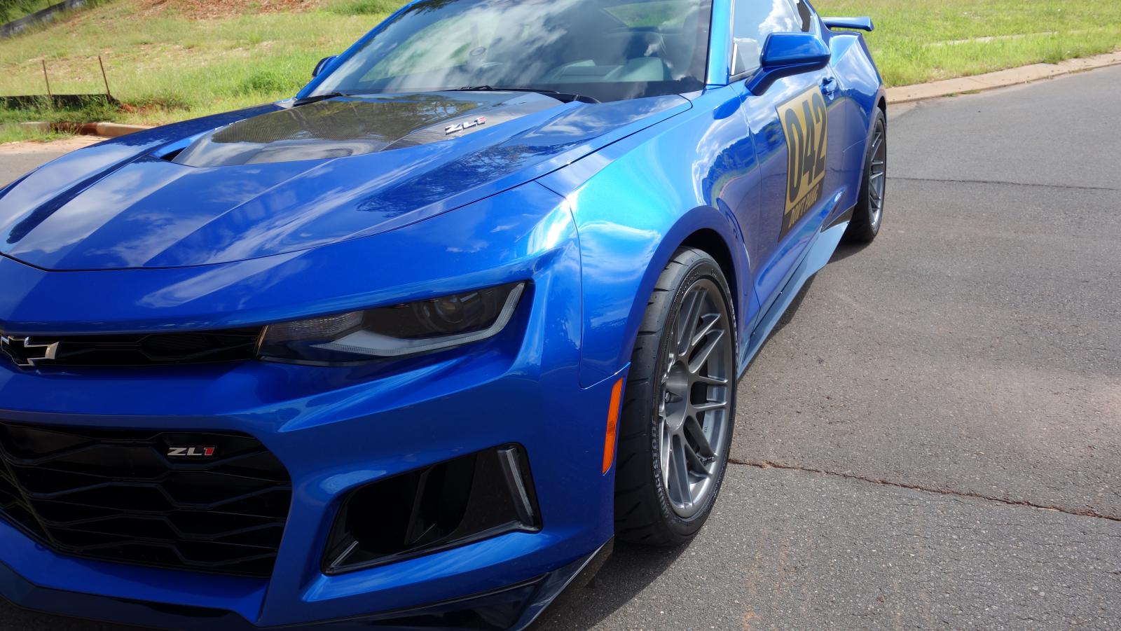

I run 19x11 square for autox with 305/30/19 RE71R tires. ET11 front after spacers and ET43 rear. Before I did the camber plates, to run these with -2.5 front camber I had to grind down the knuckes on the MRC front struts otherwise there would be contact.

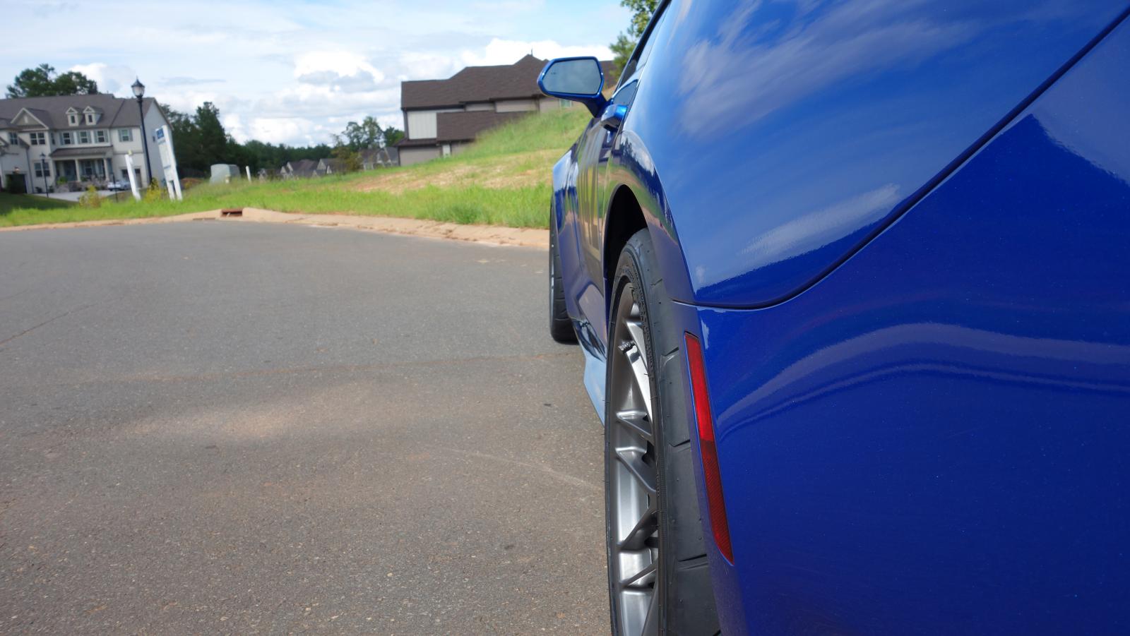

Originally Posted by SliChillax View Post
Wouldn't that make the front wheels stick out a little too much?
only 5mm...not noticeable or weird looking

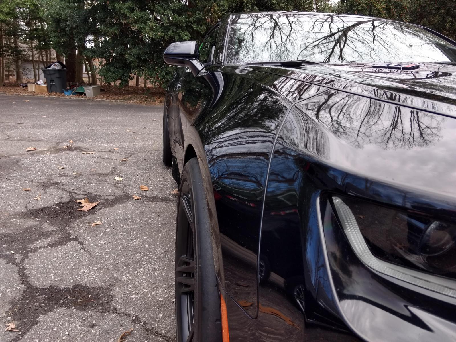

Not bad...

Originally Posted by Stephen12ZL1 View Post
Not bad...
When you add more camber, it looks normal/flush at the top. At -3.2 the top of my tire is slightly under the fender with the same offset. The bottom still pokes so I put some ZL1addons rock guards on the front.

FRONT 19x11" ET11 Anthracite APEX ARC-8
REAR 19x11" ET43 Anthracite APEX ARC-8
TIRES Bridgestone RE71R 305-30-19
1. No spacers in front, but limited to -2.0 front camber.
