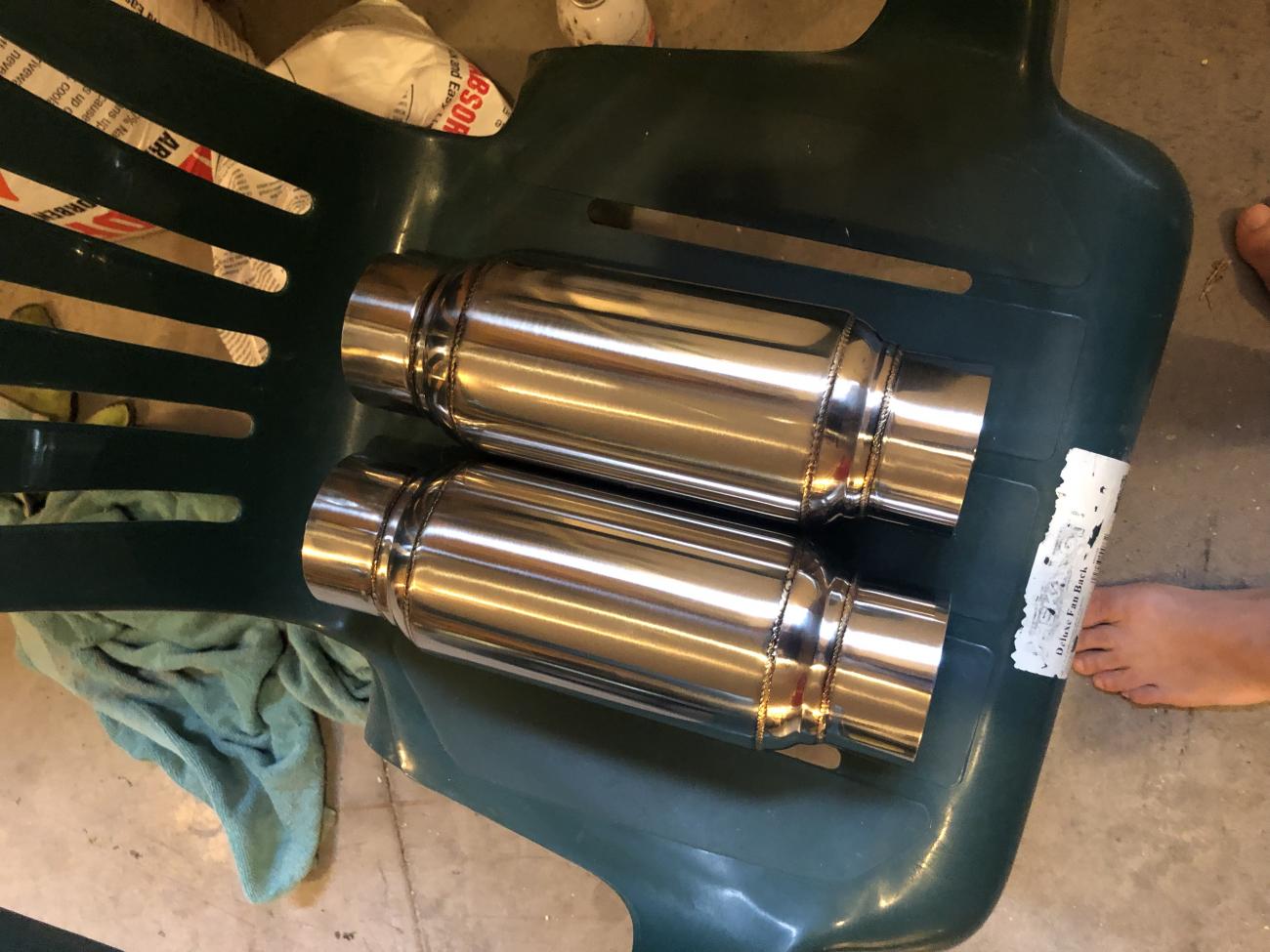

If you have no inspections I say go for it. If you don’t like the sound it is easy to adjust your set up. Sometimes I will weld in a little strait through bullet muffler to knock down the sound level a little.

I have 2” LT headers, no cats, and only added a couple of simple bullet resonators to the remaining stock exhaust as Parish8 mentioned to get rid of the rasp that is common with this setup. Doesn’t lessen the volume, just kills the rasp. I also pulled the NPP fuse so the flaps don’t close at cruising speeds. If you don’t pull the fuse and the flaps close at cruising speed you’ll hate the sound you get at partial throttle. I run E85 for the hp so don’t have the smell, but kinda liked the smell anyway.

Before I put the bullet resonators on, I went nuts researching high flow cats. I figured the cats would manage the rasp without robbing too much power and as a byproduct would deal with the smell. I actually bought the vibrant ultra high flo’s, had them in-hand, but was convinced to go with the simple bullets by the shop (I really mean simple, as in they were laying around the shop and they gave them to me. Don’t even know who makes them).
