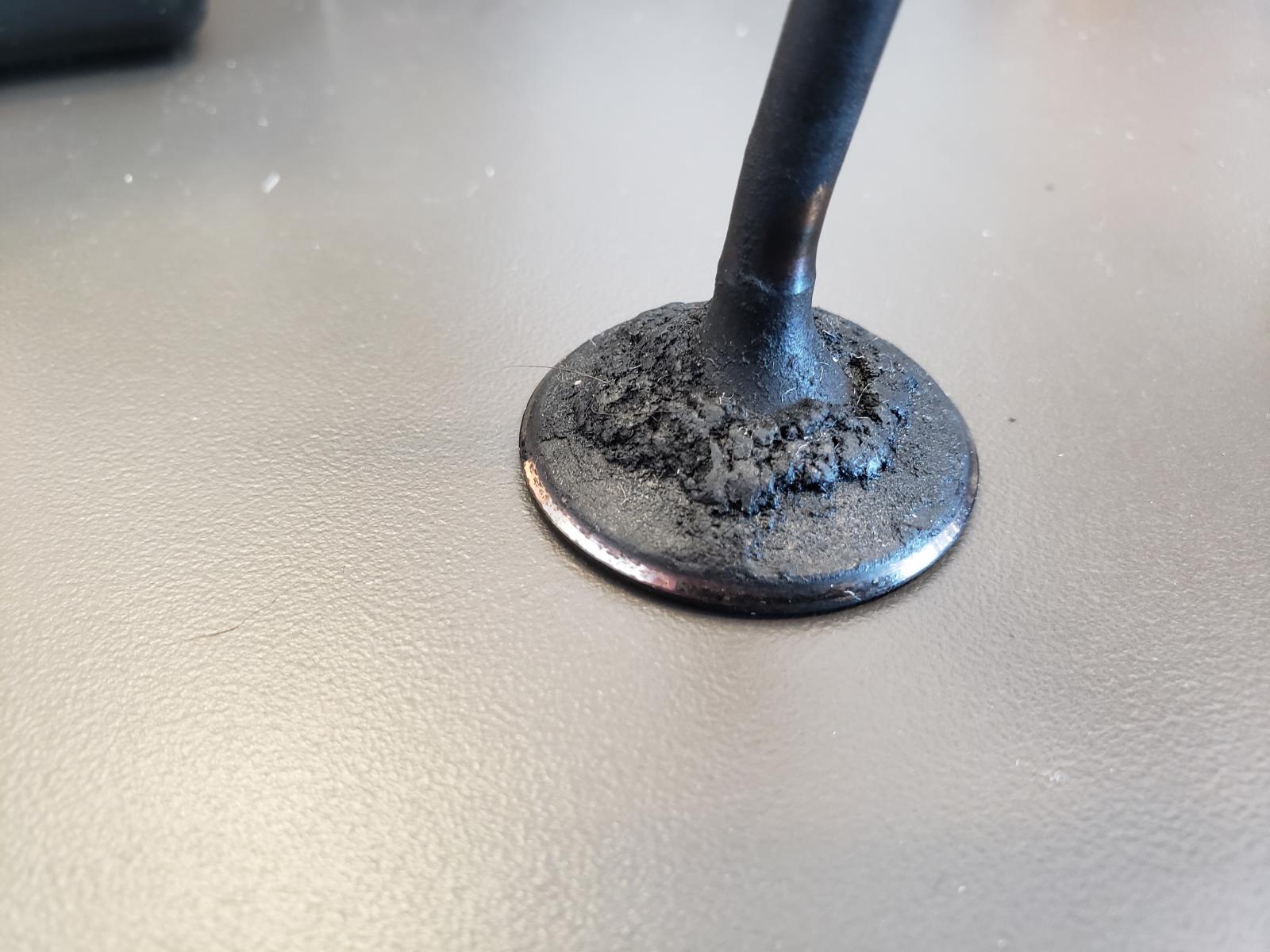

I have used this product, and I also have catch cans. The reason why is because I bought a new Silverado, 5.3liter Ecotech, in 2014. After awhile noticed a rough idle and lost about 2mpg. The truck had nearly 20k miles so I popped the intake off and was disappointed to see my valves all covered with carbon, and the ports also. I was able to pour about 6 0z of oil out of the intake, where the oil pooled at the bottom. After seeing this first hand I was convinced that the DI engines needed special care. I went to Northern tools purchased a media blaster grabbed two bags of walnuts and cleaned it out. The truck ran perfect once I put it back together. I can say from experience that the DI carbon buildup issue is real. I have rebuilt many port injected engines and some with carbs. I have never seen valves and ports so caked up in any of those engines even if they had 200K miles on them.
