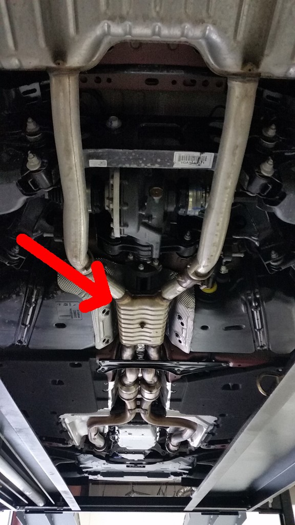

So I found where this metal grinding vibration sound is coming from. It's definitely the heat shielding above the secondary cats and also between the primary and secondary cats. None of the bolts are loose, this is just harmonic frequency vibration between pieces of metal that have no business being as close together without being securely attached as they are.
100%
I managed to get rubber gasket material between all of the metal parts that i could reach. Unfortunately, it looks like to solve the issue you need to pad all of it that is in close proximity to the body or you risk still having the vibration occur.
F YOU chevy for putting thin aluminum against metal. It's like someone gets paid to think of ways to make camaro's vibrate. Whether it's the internal plastic body parts and switches that vibrate whenever you listen to music or apparently the heat shielding from even the stock exhaust vibration. I HATE YOU. So unbelievably pissed right now. Will probably have to take this to a trusted mechanic with a lift to have them drop the exhaust and pull all of the heat shielding and properly pad them.
edit: and surprise, this has been happening since the 5th gen as well.

It's the heat shields. I've been under the car and heard the metal on metal tin can vibration just like in the video. And the harmonics change when you manipulate the shields.
They are ridiculously thin aluminum sheets that are right against but not touching and the littlest vibration causes them to hit the body. I'm taking them off tomorrow and dynomatting them all.
If in 5 years they still sell the Camaro, I'm going to make sure the heat Shields get corrected on day one. There is no excuse for this garbage

Well, dynomatted the aluminum exhaust shields above the secondary cats. Still vibrating something near there. Haven't done the rear Shields yet.
Tomorrow after work I'll get back under and do some better testing with the wife revving the car this time with me under it.
This vibration is worth a mythical curse on the person responsible. I'm 10min away from taking a hammer and going full Clarkson on the entire underside of this car.

Put the car up before work and and tightened the bracket that attaches the cats (under them) to the transmission. It wasn't loose but i tightened it anyway.
Also tightened some of the bolts connecting the plastic body panels close to the nose of the car and some of the felt panels just because i was in the area. I originally dismissed them as a potential sound source since they didn't seem to be connecting metal on metal, but they could be covering metal on metal i suppose or maybe the right thickness and type of plastic can make that sound too when hitting metal. I only tightened the ones around me as i was getting out from under the car.
at least 90% of the vibration is now gone. It still makes it for a very short amount of time at a much narrower rpm band so I'll have it back up on the ramps after work but at least now I'm in the right area. Will know for sure after work with the wife hitting the gas with me under. Hopefully not being under load will still let me hit the right frequency.

ok, so I got under it while the wife revved the engine and we are able to reproduce the vibration. Whether it was always all coming from this or not, I can guarantee that it's coming from the X-pipe resonator. Stick my screwdriver in the breather hole, and i can absorb the vibration. But there is no crack visible on the external shield. Something internal must have cracked.
So it looks like the only way to fix this is to cut the x-pipe off and replace it with a new one (not another cheap piece of crap from GM to break again). While I have a welder, I dont want to learn on my exhaust Looks like it's off to a an exhaust shop to custom fab me up something.
