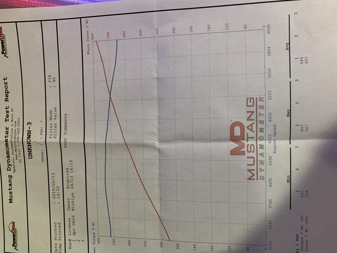

Thanks. Will do tonight. Not too worried about it car is running strong. Took it to a dyno day event at the shop I use today.
