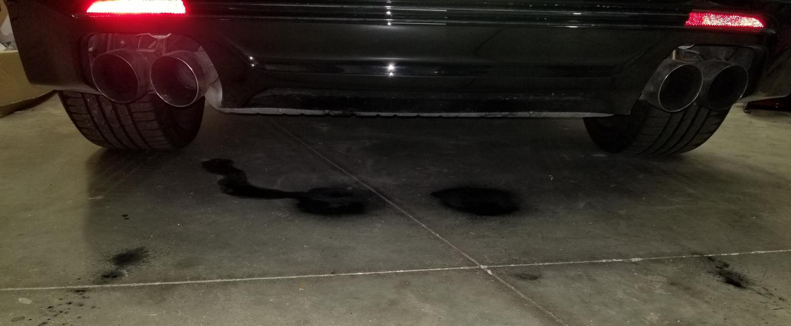

Not sure if this is all PCV/oil ingestion related, or also due to the new DI cold start strategy whereby injection pulses are doubled for the first 60 seconds to speed up cat converter light off. This strategy also results in a very sooty exhaust for the first 60 seconds, as evidenced by the black mess on my garage floor, and may explain the complaints of a rough idle and black smoke on cold starts. See attached cold start TSB.

Unfortunately the black mess on the floor is normal for our cars. It's from the weep holes in the muffler letting out condensate. It also makes for a pair of lovely stains on the muffler.
