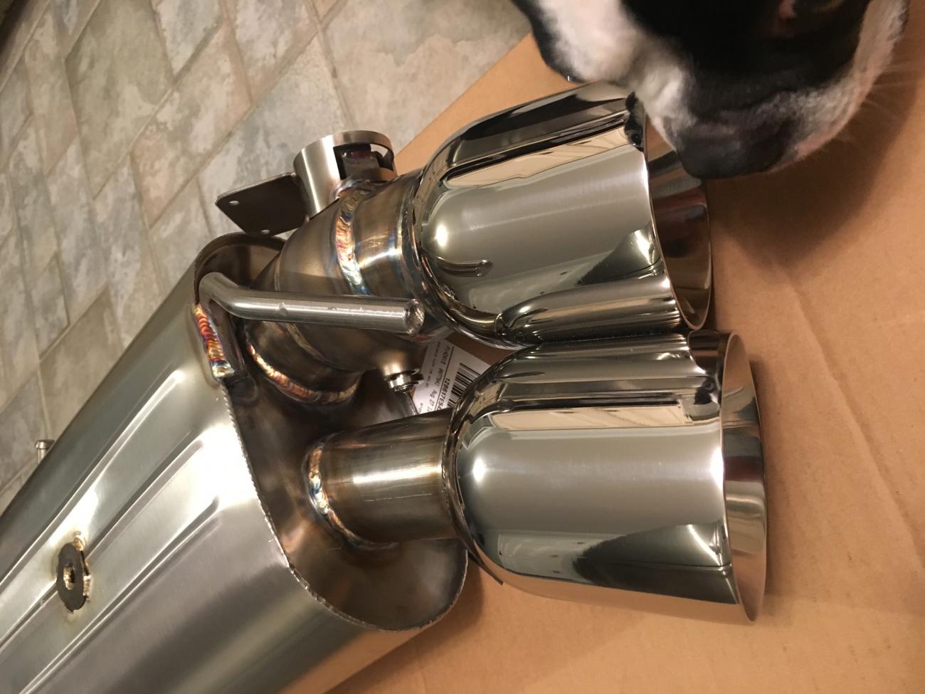

Old 04-15-2019, 01:26 PM   #10
Steve 2016 SS
Drives: 2016 Camaro SS
Location: Georgetown Ontario
Posts: 131
Originally Posted by enzia35 View Post
That's always been my question too. Here's an Amazon review, take it for what it's worth:
I just bought that exact system and have the same car as you. Cant wait to put it on!!
