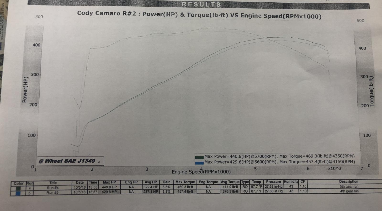

440Hp / 469Tq output (See Giant Dyno sheet)
Name:  Camaro ss dyno.jpg
My current mods list/ 440Hp/469Tq output (See Giant Dyno sheet)

From what I've seen/ read you'll need a cam to break the 500whp mark with the A8 for an NA build

It's highly unlikely to do 500whp NA without a cam. It has been done tho...
Pray had done one but I believe that car had an underdrive pulley and 2in headers as well as a ported MSD and ported ZR1 TB.
Cam should get you to/above 500whp with little issue

It has a ported high ram and made 505whp in 5th gear.

That’s my goal as well, so far I’ve got kooks headers, Cat delete, mbrp cat back, MSD manifold, e85, ported stock TB. I’d say ported heads may get you there definitely a cam. From what I’ve read the nick williams TB is overpriced for the gains you’ll get. I’d go with the much cheaper option with similar gains and port your stock Tb

Heads will do it properly set up.
