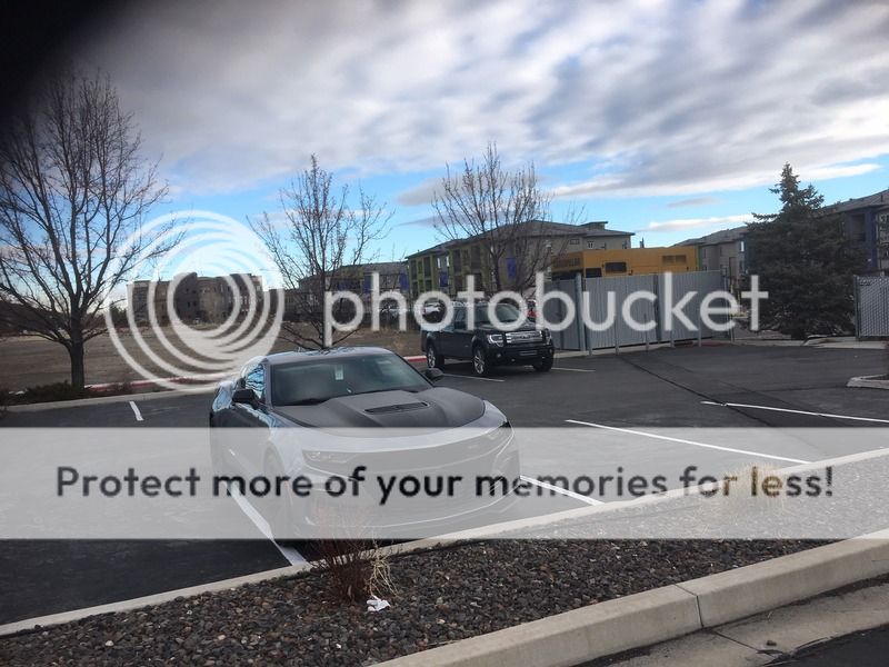

took a cellphone pic this morning:
Gasoline_Farts is offline   Reply With Quote
So. Much. Better. Looks great!
