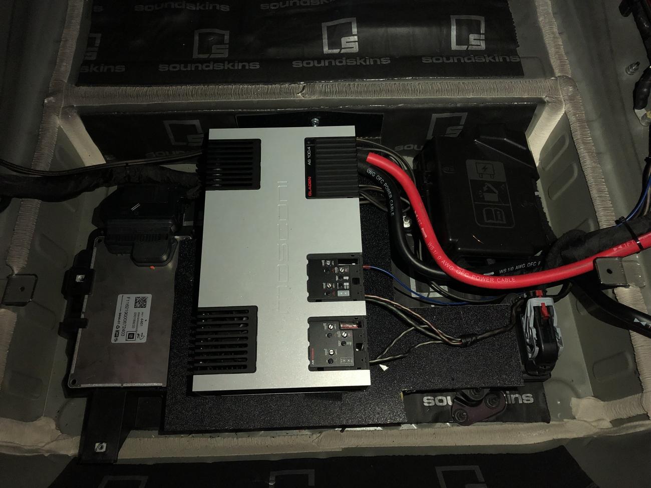

Amp Ground noise
Getting a ground noise with no inputs connected to the amplifier, any ideas? When only the radio is on, there is a clean signal. But once accessory power is on the noise starts.
The amp is grounded to the battery.

Interestingly it comes and goes when the DRLs are on.

No external amp, getting signal from a PAC Amp Pro. However it’s not from the input because when I unplug the input from the amp the noise remains.

Ended up being the driverside passive crossover. There was some wiring running by it.

The crossovers were located in the footwell behind the carpet. So by drivers left foot and passengers right foot. I would recommend installing them in the trunk next to the amp.

I have a quasi three way setup up front, with passive crossovers between my tweeter and 2.7" midrange driver. As you mentioned, we mounted them in the trunk near the amplifier.
