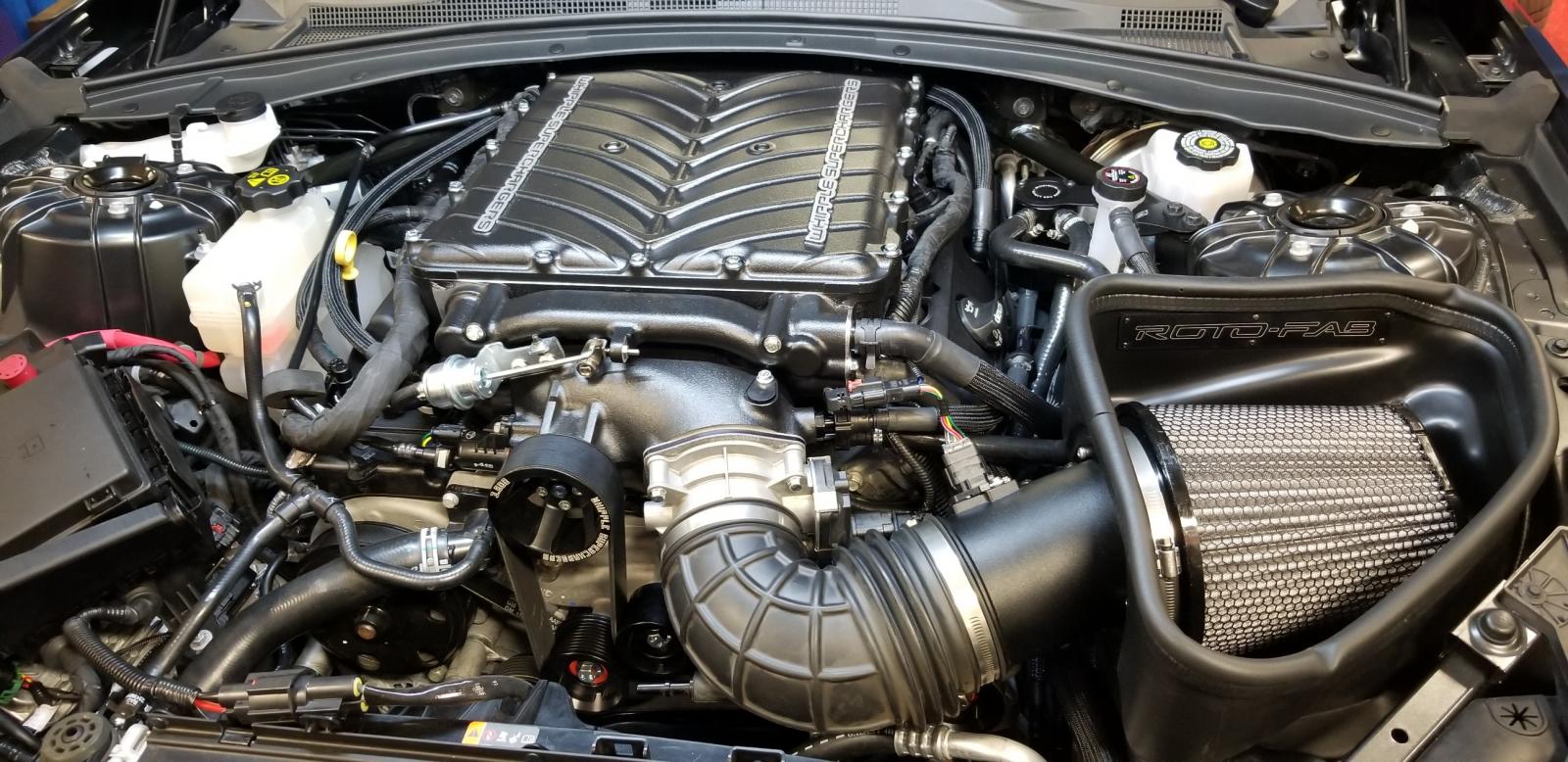

Finally got my Whipple build finished up and on the Dyno.
Setup is:
Whipple 2.9 with 3.5 pulley(8psi)
Ca performance cat deletes
Rotofab dry
Ported LT5 tb
LPE DI pump
LT4 injectors
ZL1 intank with JMS booster
Flex sensor on E80
305/35/20 555r Nitto
I don't have a base line so the Dyno numbers are what they are. It made 596whp in 5th gear @ 8psi on a Dynojet. From what I have seen 5th gear reads 25-30whp low compared to 6th. I'm sure the tires are probably eating a little power too.
For reference there was a C7Z M7 with Headers, Pullies, LT5 tb, CAI, E85, and fuel system, it made 650whp @ 10-11psi. This car also made 700whp on another Dyno.
Fuel system seems to be ok. Low side holding E80 like a champ, the High side pump is maxed and just slightly dropping pressure. It holds E70 like a champ.

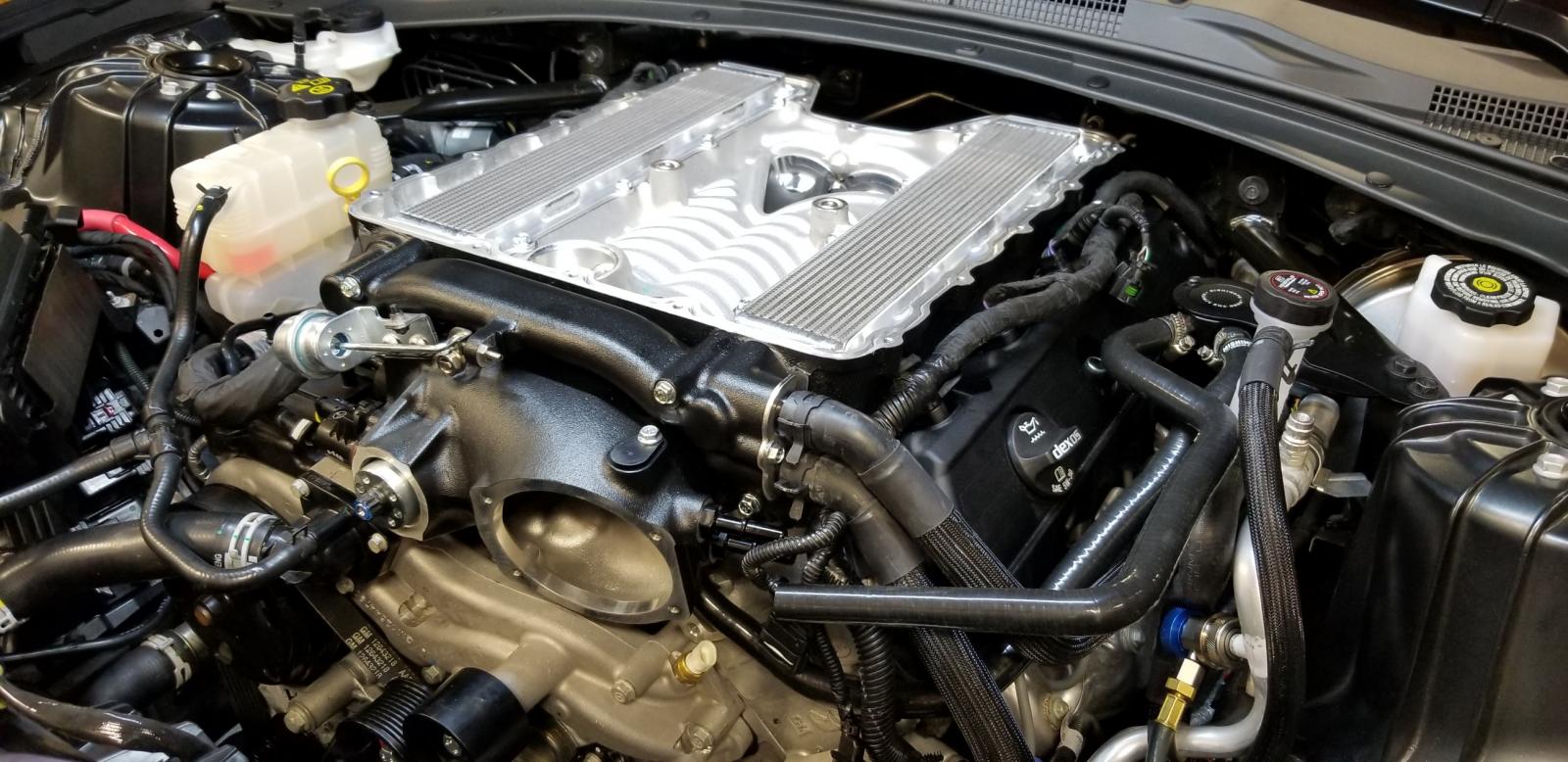

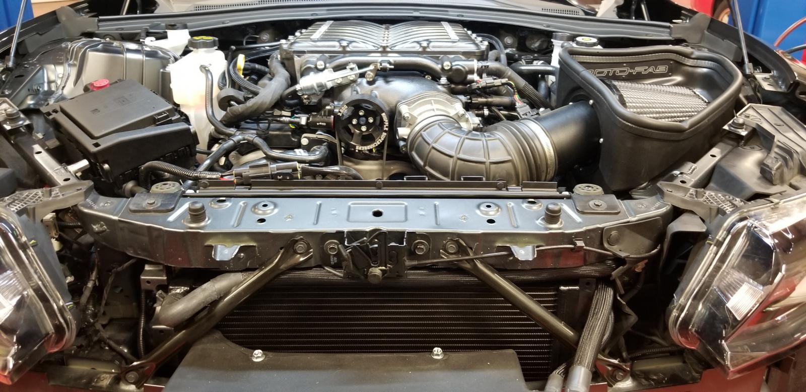

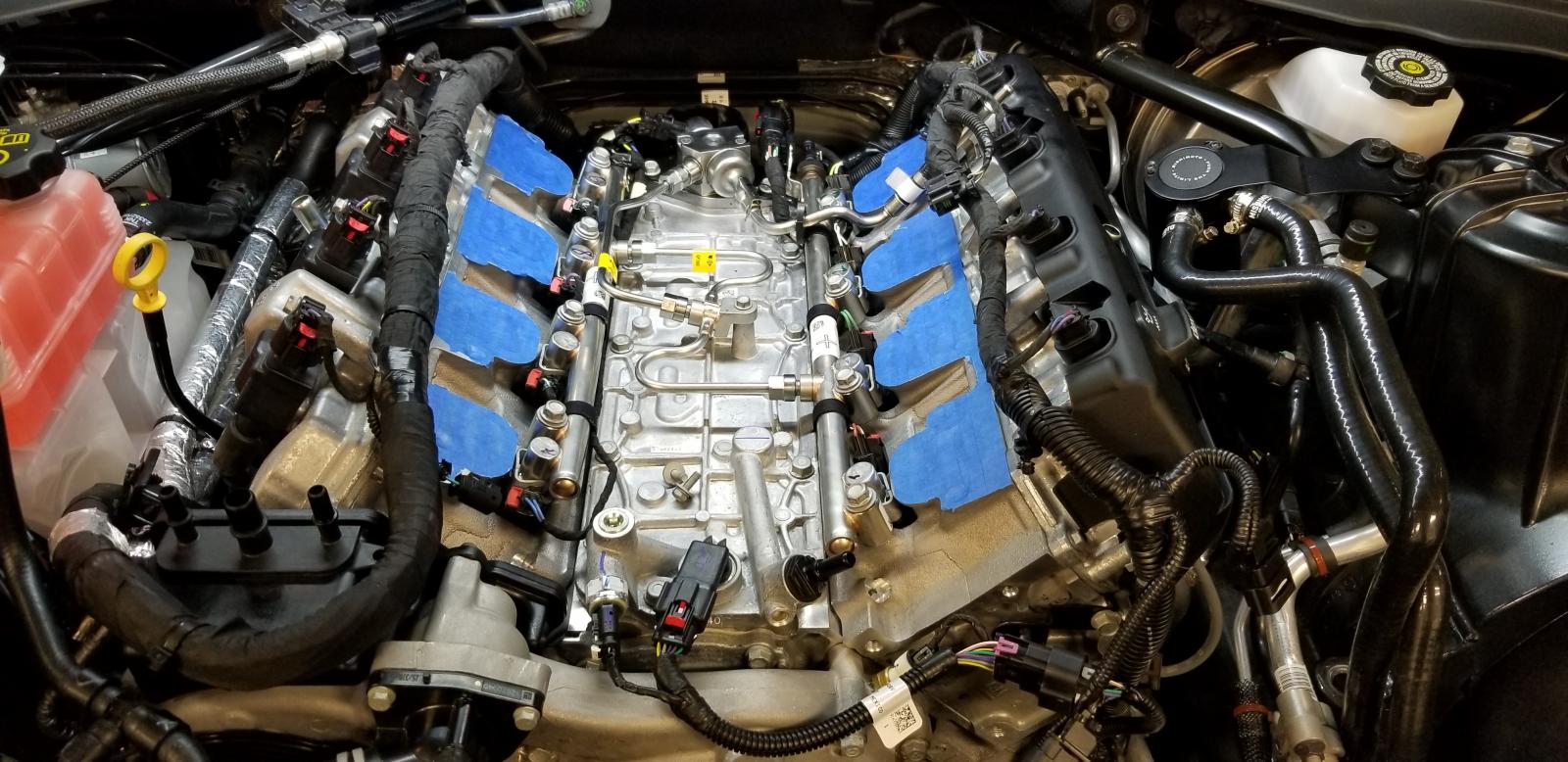

I attached a few pics of the build.

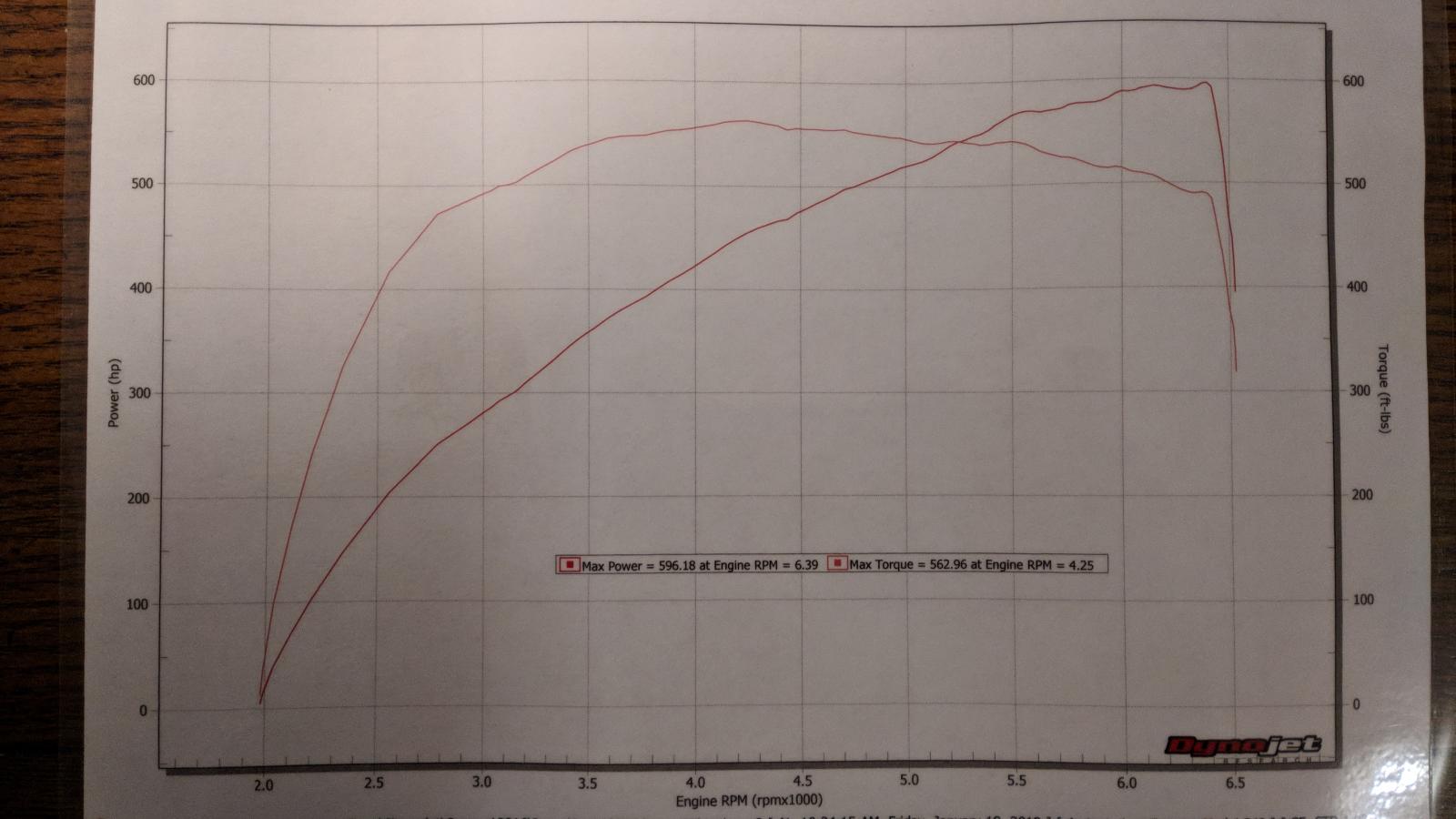

Here is the Dyno graph 596whp 563wtq in 5th.

Thanks. Yes the power curve is stellar...big fat torque curve but it still builds power clear on out.
