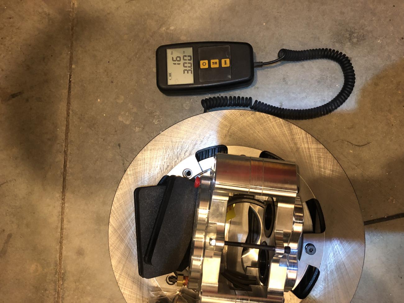

I haven’t driven it yet so this is a little premature.
I got the aerospace front street(vented rotors) kit and some stainless lines from gpi.
The bad. Right off the bat aerospace shorted me a couple of spacers, grrr. Then 3 out of 4 of the caliper bracket holes needed tapped out to get the bolts started. There was an obstruction that you can see in the pics. 3/8-24 tap.
The good. Nearly 24 freaking lbs per corner. They told be 40lbs saved total so this is more than advertised. Nearly 48lbs total off the front. Also the caliper bracket lines up perfect for adding a front speed sensor that I want to install.
I will update when I have more info.

Same issues i had! Pita during the install. They didnt short me spacers but the spacers were short. Had to add washers to center the caliper over rotor. I got the front drag brake kit though. Didnt realize how much thinner the rotor was going to be compared to the pro street rotor you have but everything seems to be working fine

I got them completely installed last night minus the spacers. Didn’t run into any other issues. Hopefully they get the spacers out fast. We have some decent weather right now so I could be out driving.

There is a perfect place to mount a front speed sensor on this kit.

That is some nice weight removed this will be my next mod front and rear . Sad that the threads were jacked up .

Its a really nice product. Tightening the brake lines feel dicey and they may leak so you'll have to recheck your work. Also, use the proper bedding procedure for the pads and they will feel almost like the stockers.
They are almost zero drag so the down side is the pads may rattle some in the caliper when the brakes aren't applied. Centrifugal force is also greatly reduced so with the front skinnies on, turning at speed is like butter. You'll love em.
