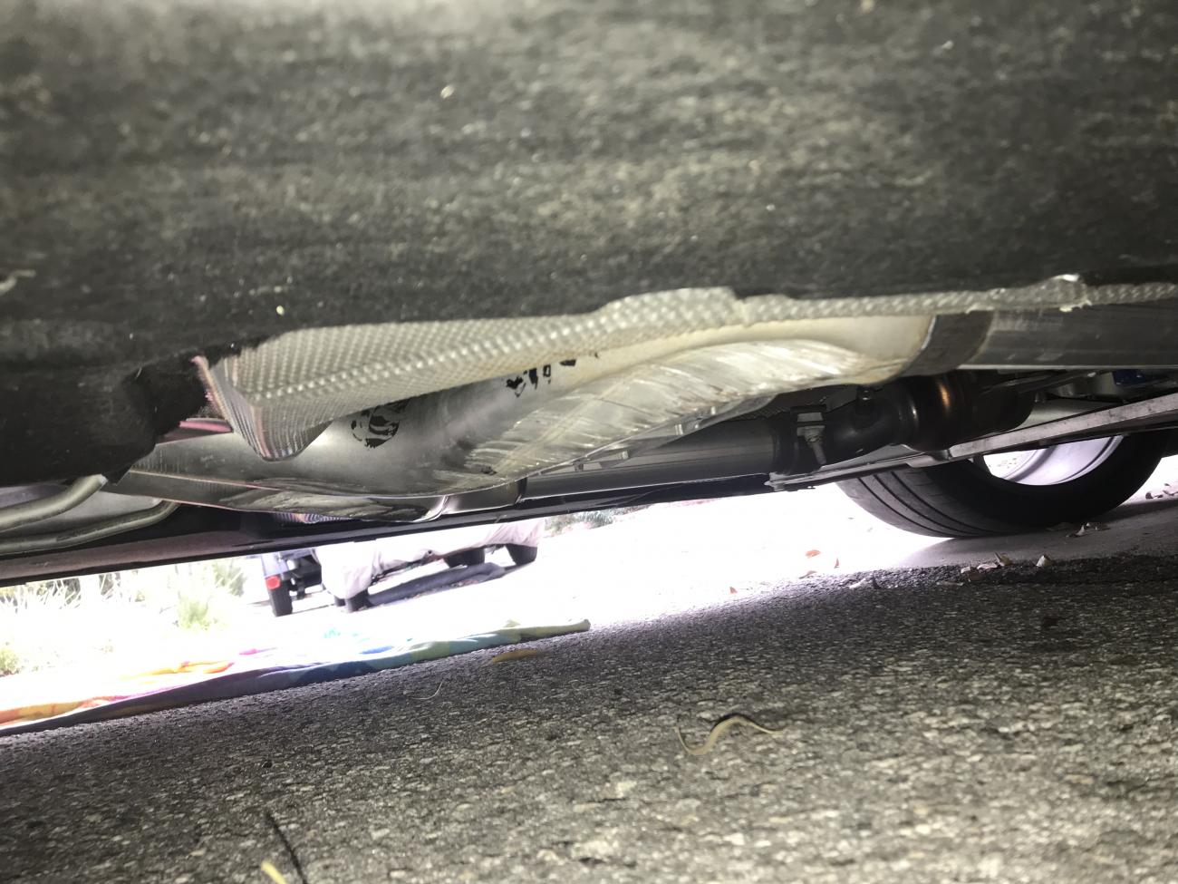

This is what the damage looks like. First exhaust shop was certain it would cause no issues or any flow or sound trouble. Opinions?

Hard to tell from the pic but it just looks like alot of scrape damage. I don't see how that should affect the sound drastically at all. Maybe sell it and get the race catback instead? Tbh hearing the videos from MBRP, the street catback doesn't sound good at all.

When I looked at it before putting it on that area withcdamage had like a 1.5” diameter vs 3” everywhere else because of the significant dent. They’re charging me a restocking fee and shipping return so I’m trying to figure out this one
