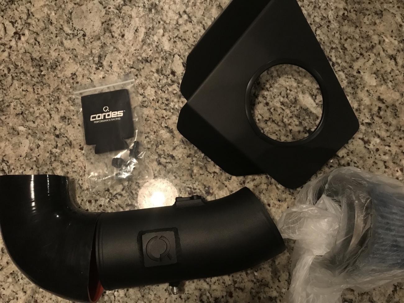

Old 02-04-2019, 07:54 AM   #13
ShizzySupra
Drives: 16' Camaro 2SS
Join Date: Sep 2015
Location: Oregon
Posts: 381
Mmmm goodies.... Cordes 5” arrived. Really awesome to know how much testing he put through these pieces as well as literally swapping them back and forth with other brands for comparison. Happy to continue to support him.
@DeathWatchCamaro on Insta

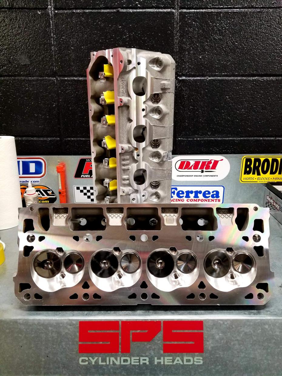

Old 02-04-2019, 08:24 AM   #14
ShizzySupra
Join Date: Sep 2015
Location: Oregon
Posts: 381
Kind of a surprise move but I was happy to collaborate with SPS for a set of heads, ferrera valves, and some milling... I think its going to be scary how much power I will pick up just from these. I had bone stock LT1’s this whole time.
