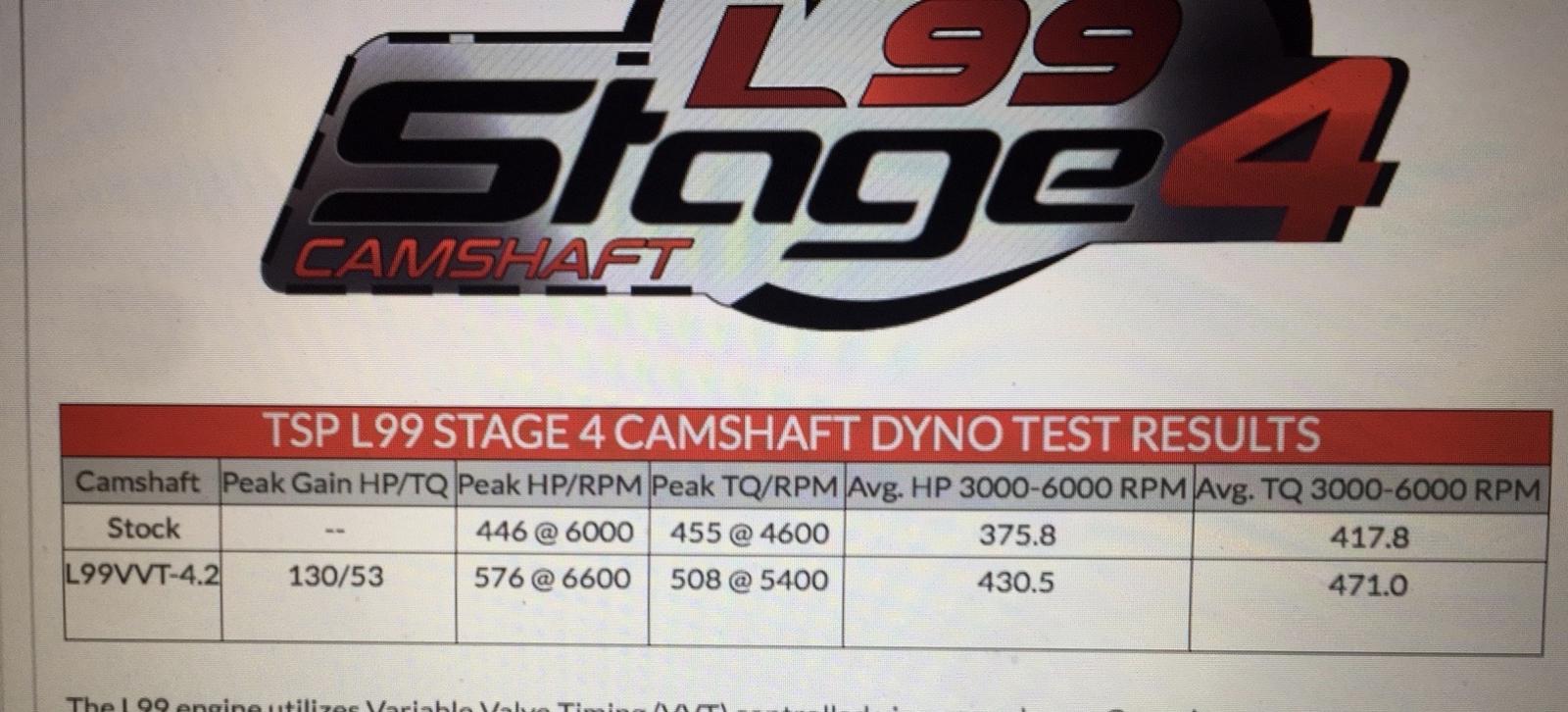

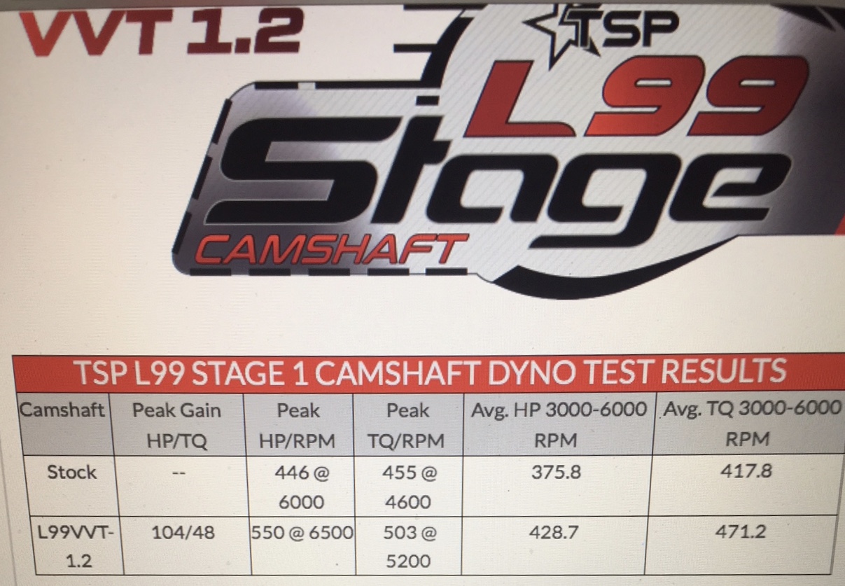

@sal from their website, gives you ave tq readings from 3000-6000 rpm. All well above stock whether stage1 to stage 4. I have an S3 with a manual. I had to relearn to drive which only took the 3 hr ride home from the shop. Best way I could describe was when you first get in the car, feels like first gear felt like you were trying to pull off on 2nd gear but not that extreme by riding the clutch. After a couple of hours, Im taking off like it was stock, rush hour etc ...fluid but with more power. Lopey idle is the icing
