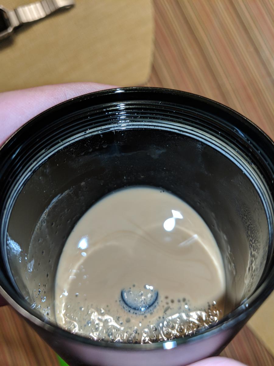

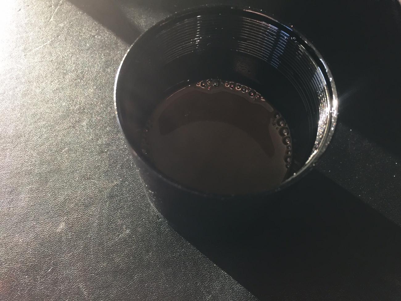

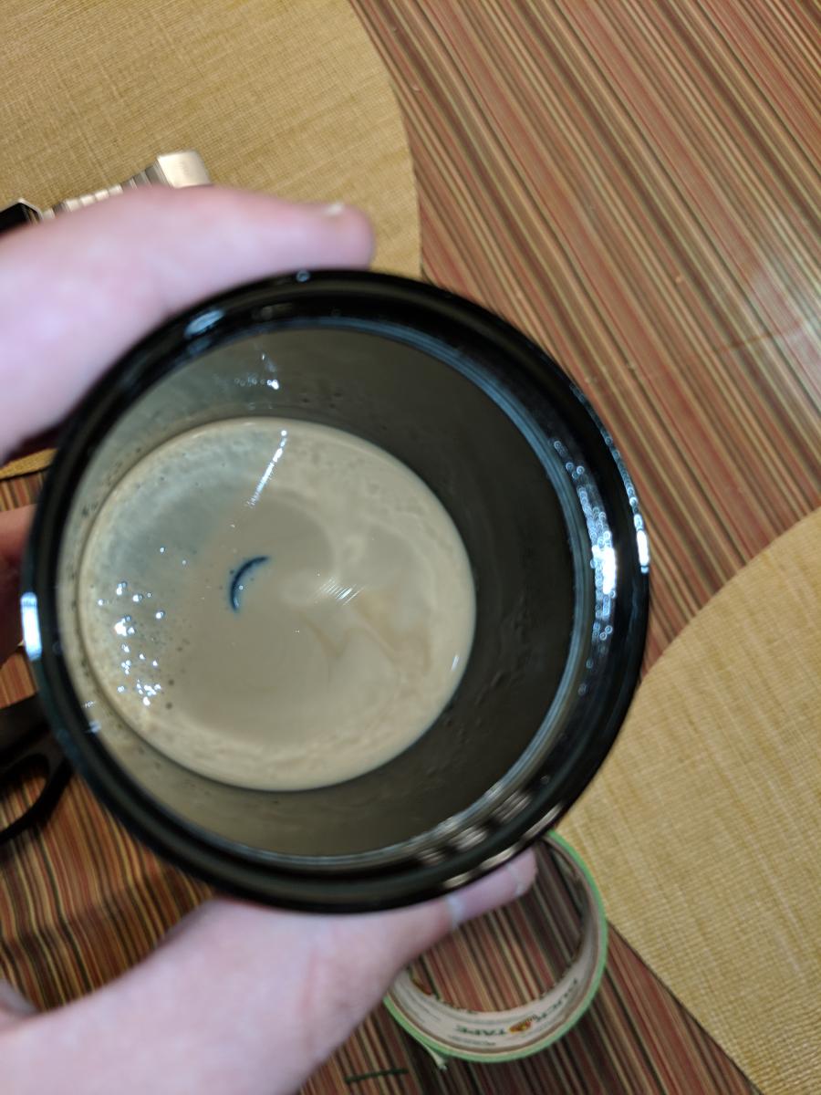

Checked my Mishimoto catch can on my 18 SS 1LE today after 500 miles. I had the oil changed last time I drained it so fresh oil. It looks like Coffee. What the hell? The first time I drained it it looked like the image with the dark oil after 900 miles. 2nd change after 500 miles is yellowish???? What could it be?? Name:  IMG_20181103_191651.jpg

That's normal when it gets cold. I believe you end up getting more water in the mixture and it becomes that milk chocolate type color. Mine is the same way this time of year through Winter.

Yep - the colder is gets job the more it will look like creamy coffee.

So it just looks like this in the catch can? The oil in the pan should still look normal I assume? I should drain a little bit to check

The oil in the pan is not milky. Your just condensing water in the can.
I do recommend caution. I had a catch can on my 2016 and as temperatures dropped into the low teens the can was filling with water in one weeks time. The result was the crank case wasn’t venting properly and the oil reeked of fuel.
After I found the can this full in four day, I took if off and changed the oil. Because it was cold outside I had the garage door down and the garage smelt like gasoline. I won’t put a can on a car ever again.

Normal, no need to drain the oil...
