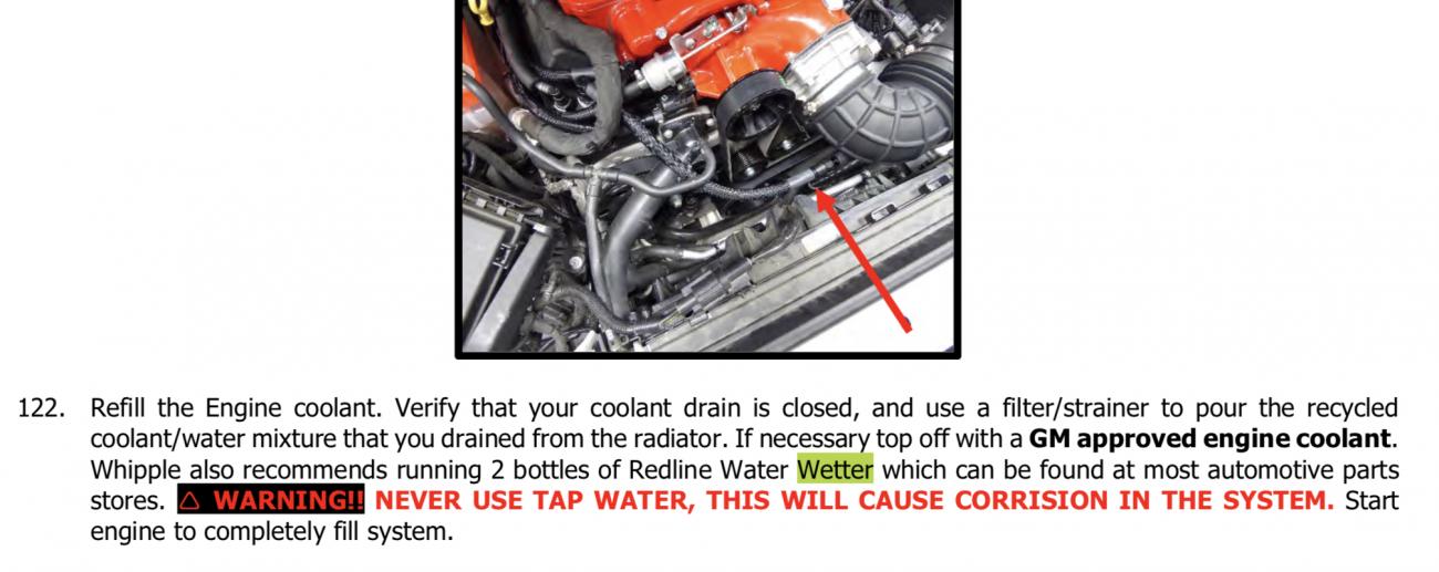

Originally Posted by Jhunsberger View Post
3 bottles of water wetter.
Good luck with your build!
Just my two cents, I wouldn't use water wetter. Use the correct GM coolant instead.
Goldfish is offline   Reply With Quote
Old 10-09-2018, 07:56 AM   #5
Its added to the GM approved coolant. Also whipple recommends using it right in their instructions.
Once again this just my two cents and it's worth exactly what you've paid me for this advice, but water wetter is basically like snake oil, especially if you're going to run coolant instead of straight water. The ASTM corrosion standards that they meet are also significantly less than what would typically be required of engine coolant. If Whipple calls it out in their instructions, that certainly is a head scratcher.

Yup they call for it.
Taking suggestions from instructions that doesn't use spellcheck?
