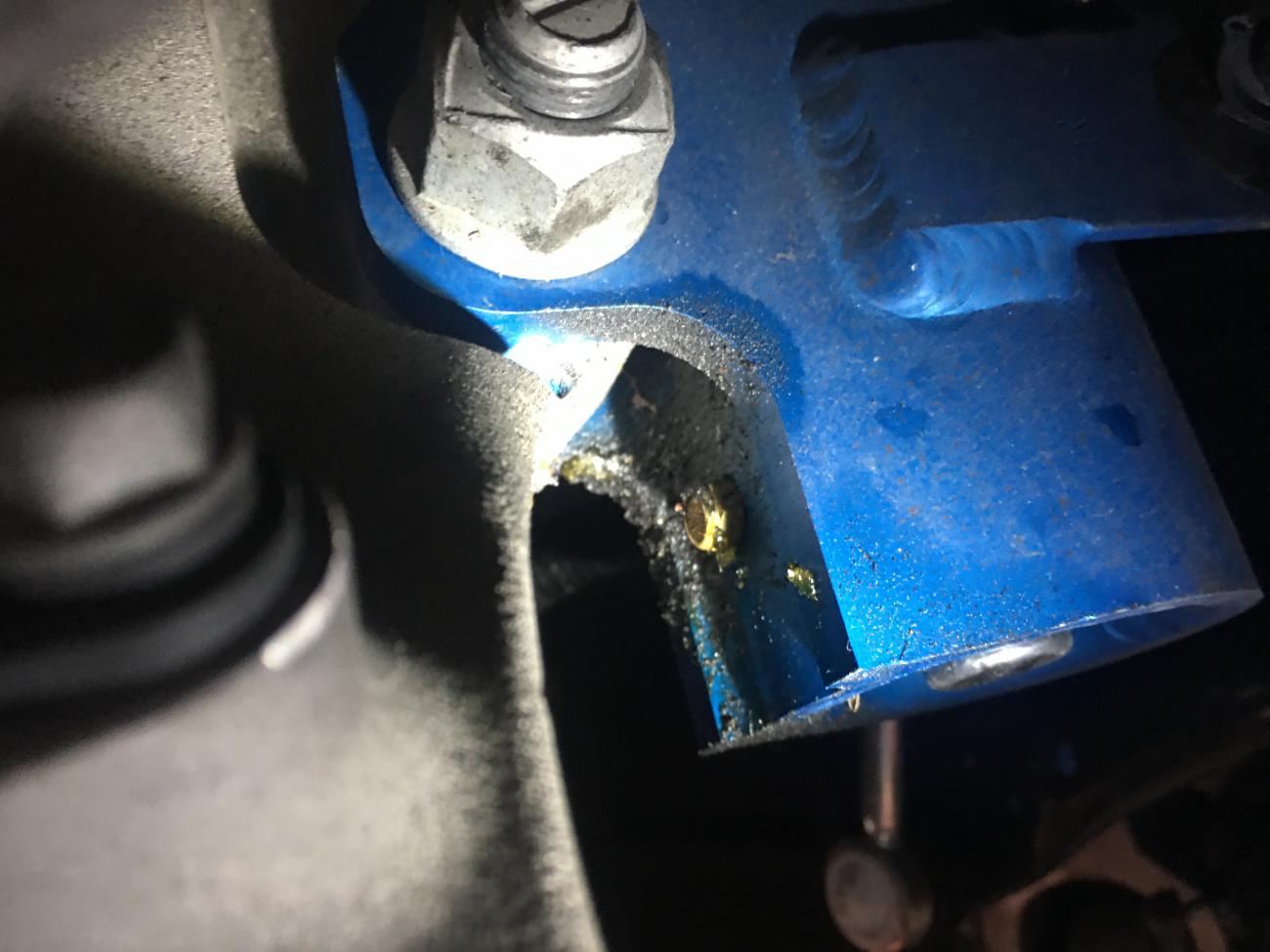

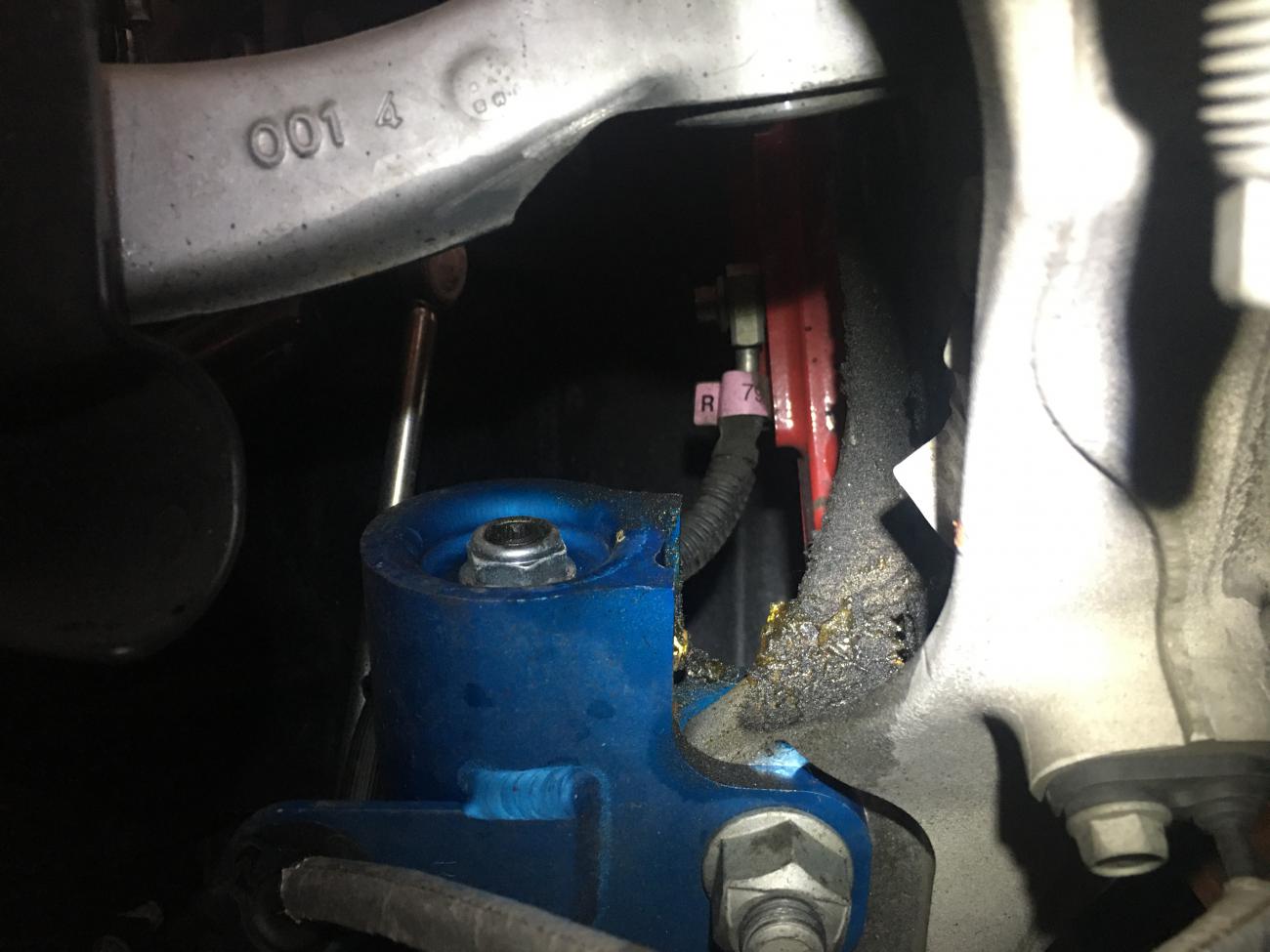

Just completed break-in and preparing the car for Road Atlanta. Had the car up on the lift doing the 15-50 mobil1 oil change and we notice the RF strut is leaking it appears to be coming from a nut on the very bottom of the shock it has spayed oil on the control arm ,wheel , caliper ect.

Want to take a picture? Does it look more like a thicker grease coming out of the gold color breather valve? Or a lightweight oil substance from the bottom?
I had an issue with the damper making a knocking noise and leaking. Dealer replaced under warranty.

More like oil coming from the bottom right around the nut at the end of the strut.

Best I could do on my back , you can see the film where the dirt attached itself to the oil on the control arm where I wiped it with my finger .

Saw dealer today new Multimatic Damper on the way from Michigan overnite will install and align tomorrow. The bad news is it was a damper leaking @ 1300 miles. I hope this is just a fluke but you guys out there with Z-1LE's might want to inspect yours.

A small amount of grease from the gold breather is normal according to research found about last gen's DSSV dampers. It became a concern of mine when there was an excessive amount of grease on the damper, brake caliper etc. I also had what appeared to be oil leakage similar to what is pictured above.
The only reason I began to look at the damper more closely was because of the loud "knock" that I had (Posted about it a few months ago). It was the internal damper shifting inside the casing causing the sound and most likely causing the excessive grease I found.
