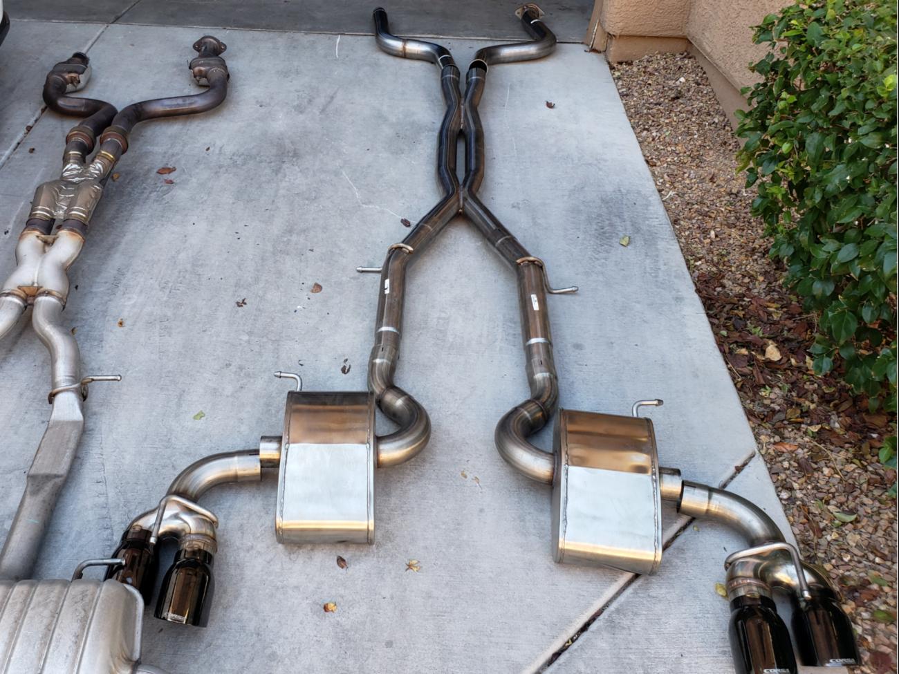

This weekend I installed corsa's new double X with the extreme axleback. First I want to say the quality is amazing and everything fit perfect. This system deletes the secondary cats and is all 3" back to the mufflers. This system is loud, and has me considering switching to corsa sports as the ol lady thinks our neighbors are going to call the hoa. I leave the house at 4:30am on weekdays and startup is no joke with this setup. Other then that it's amazing, 0 drone at any speed, near silent on the freeway, can cruise around at stock like noise levels, but touch the throttle and it comes undone.
My only issue (other then the neighbors) is the car feels noticeably slower. The low end torque just doesn't feel the same. Is it me? Or have other felt this also.. iv heard these car will adjust for over temp cat protection, and dump fuel to cool the cats. I have no CEL but it doesn't feel the same on the hit.
