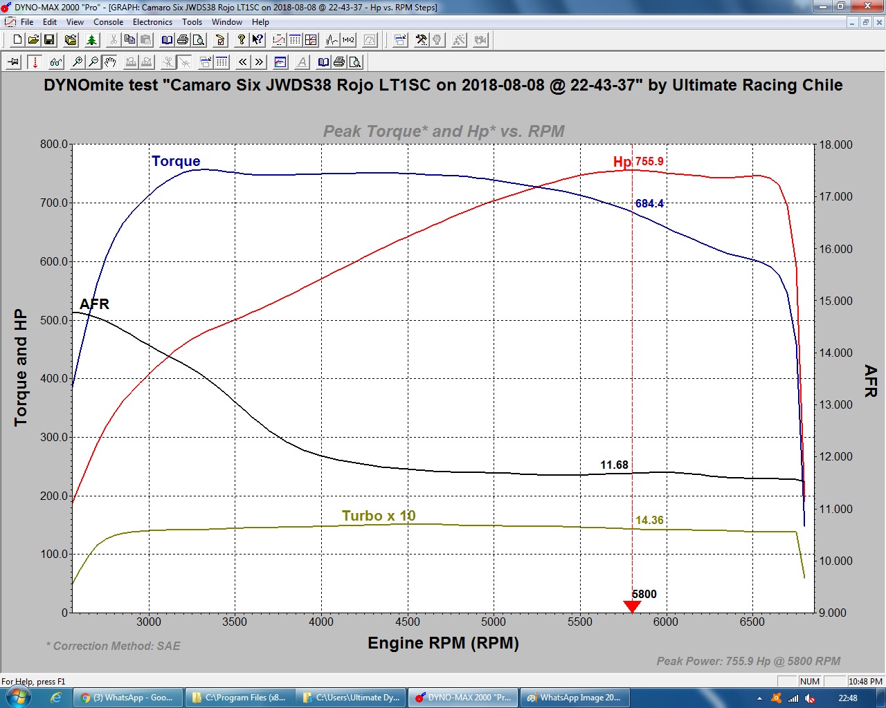

I update my build with a VR Pistons , FIC injectors , TSP custom Cam and 2.75" upper pulley / 8" Crank Pulley.
The change its wonderfull , pass to 650whp to 755whp in fuel pump with meth injection , cars run perfect with 14.3 psi of boost.
All spec of the build :
VR Drop in Piston
TSP Custom cam
FIC high flow injectors
LT4 High pressure pump
LT4 Intank Pump
Whipple SC 2.75" Upper pulley / 8" Crank Pulley
Dynatech 2" Headers cat delete
Afe Full exhaust
Aem Meth Inyection

Is the bottom line supposed to be your boost level?

Nice flat and instant boost as expected from a PD. 5800 HP peak seems low for cam and headers, especially since boost is still holding. Are these FIC injectors 30% bigger than LT4?
