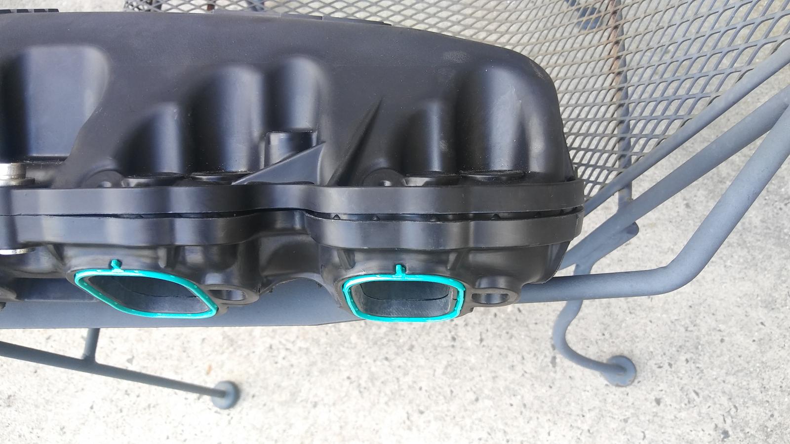

The gaps in my MSD were belligerent even after tightening all the bolts properly. I took it back off, a bead of RTV all the way around and put it back together. No problems since.
Attachment 951319
You put RTV In between the upper and lower part of the intake where the gasket is?
Also, how did you know yours was leaking?

Yes. I took it apart and applied a bead all the way around and retightened it.
It thru a check engine light on the way to the dyno shop, car was running lean. We thru fuel at it and the trims were still way off, put a smoker on it at the rubber intake coupler and found the leak. The photo I posted was Before I took it to dyno so I had a sense that was the problem.
Also re-torque your bolts from time to time, they may back out on you.
