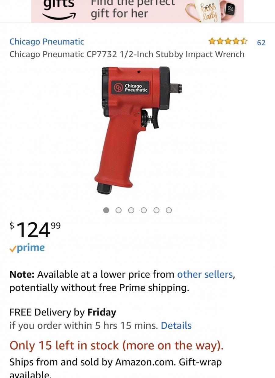

I see people having trouble with the crank bolt. On my last two cars I have gotten them both off in seconds with this thing and a shallow socket from harbor freight that was like 5 bucks. First car took it right off instantly. My new car I heated it for about 15 seconds with a propane torch and then ripped it right off. It’s an awesome tool to have anyway for tight spaces. Might wanna grab one if you do your own work.
