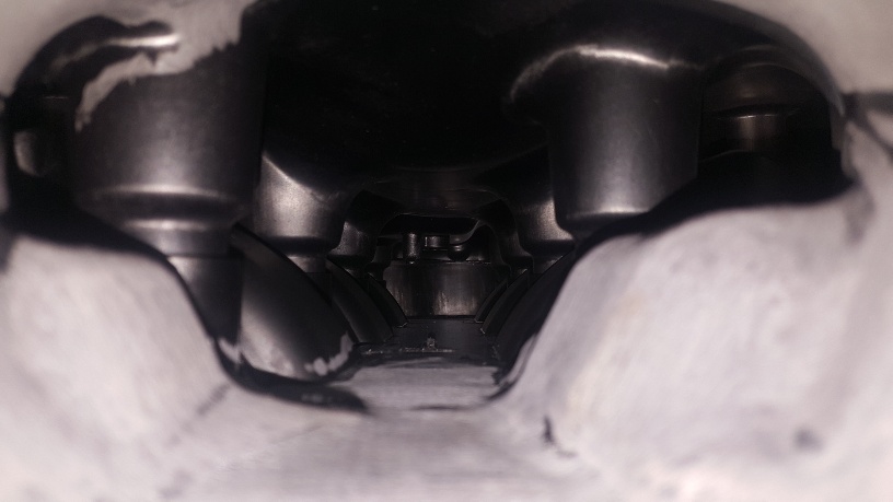

To start off, the porting job and fill job, sexy! Its just like it was for the 5th gens, some work has been put into it. Looking inside you would think it should be from the factory like that. Its obviously a bit heavier,

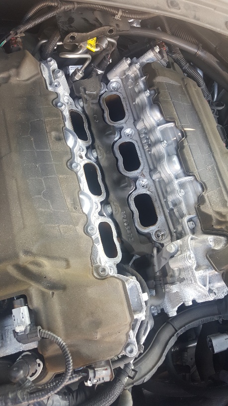

Before I installed it, I had to tap a ¼ npt in the neck of it, as that's where the port for the 3rd outlet on the catch can goes. Problem is, I couldn't find the tap I had or bit I bought, so it took some time to get the right stuff...like a day or two. Finally got it drilled and tapped. Installed it a few hours later.
Some have posted that the install or removal of the manifold is hard, mainly the last 8th bolt at the end of the manifold resides under the cowl area on the driver side. They are 14mm bolts, I used a ¼ inch socket and wrench and got it out about 95% of the way, did the rest by finger. Yes, with my hands its a TIGHT fit, but index to thumb works. Once you remove all other 7 bolts, on that last 8th bolt, pull it up by hand most of the way, tilt the manifold backwards a bit, then dip it forwards where the nose/neck goes down. Came right out. For me it took literally 15 seconds to get it out after looking at the situation for 5 minutes and thinking what to do the easiest.
There's also two small 10mm bolts on the rear of the manifold that go through a plate. Easy as those have inserts to clasp into on the manifold. So once its loose, you can do em by hand.
Installing the new ported manifold is the same. A bit heavier so some may need to steady a bit more. Remember to hold the 8th bolt half way up, getting it back in is the reverse. One thing to note, the rear MAP sensor I think it may be, it has a security bolt. Its like a 3.5mm Allen maybe, but it has these longer lines. I'm sure there's a key for it, but after trying to reinstall it and starting to strip out the center, I replaced it with a random Phillips screw I found in my cup holder. I don't know the size, but for anyone who will remove this on the manifold and doesn't have the key... a course threaded screw will do the same and better if you have to remove it for any reason.

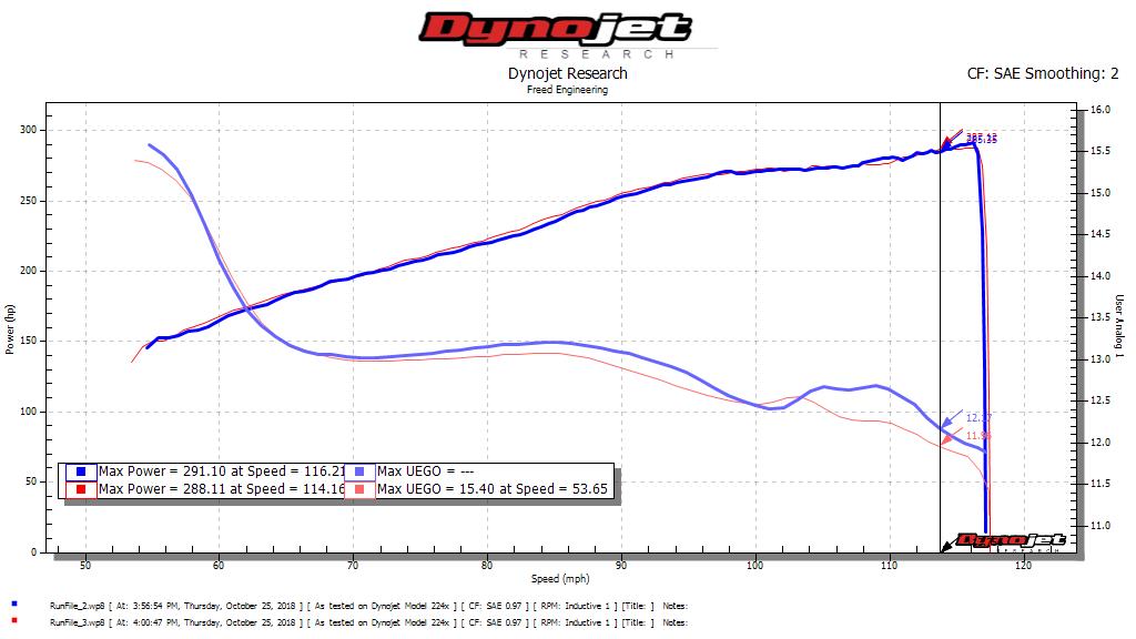

Dyno Numbers Finally...
Sorry for the wait, but getting around to things as quick as I can. After the Idaho trip in Aug, B-day in Sept, then Just got back from Universal on Monday. Work, wrestling, and life (the parts you never wanna deal with)... cash has been limited and time even moreso…. then factor in trying to schedule time at a shop. Some of you already know how that is.
So the stuff completed so far:
-JacFab Manifold ported and filled
-Vmaxx TB
-GM Intake with reflash
-Elite Eng. E2x catchcan
-2.5 inch exhaust, personal build, MagnaFlow 6 inch rounds, Mag Tru-X pipe.
wanted to wash the air filter since I haven't touched it since I installed it last year in the fall. don't think it would make too much a difference.
Pull 1 was a kinda half pull... basically he noted that with that gear, the engine would have been doing 150-160 road speed, which isn't anywhere near where id be going through the traps at.
So pulls 2 and 3 were done with 4th gear, and that's usually when I cross the 1/4 mile line, given the tires and wheels I have. I usually just switch into 5th gear then a split second later over the line. so that's the premise for using 4th gear.
Also the shop I went to usually does a lot of high end 1200+ LS builds. but we used a dyno that belongs to a place that does similar 300zx/supra/jdm builds. so for some reason torque wasn't logged or set to BE logged. but we used a speed reading to calculate from the data from HP tuners to get torque which was around 250-255 at the 5250 (5252) mark.
the Dyno was a Dynojet 224x in ground.
Pull 1 - 6th Gear
Pull 2 - 4th Gear
Pull 3 - 4th Gear
apparently the A/F got a lil lean towards the end, and that's with the GM reflash. so there's still room for more.
Tomorrow, if the gods smile down, gonna head to the track right after work. gates open at 4:30 track goes hot at 5. however, its supposed to rain, so that might be depleting. Sat is rain, and theres autoX up in PA... will try to check it out, but sunday is autoX at the home spot. so i'll more than likely be out to that one.
