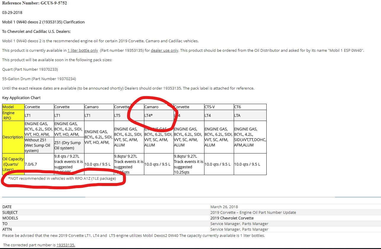

I would stay away from M1 ESP 0W-40 on the track, at least until we receive an explanation regarding the asterisk*.
Attachment 948838
Here's my assumption... Since it specifically says not applicable to the ZL1 1LE... The tires are stickier and can endure more cornering g's. It's probably a little on the thin side and has a potential to starve the oil pump on sustained cornering.
Interesting theory. Makes sense, especially with a wet sump.
ESP 0W is recommended for the LT5. ZR1 cornering Gs exceed or are at least on the same level as the ZLE. Dry sump oil delivery may very well be the difference maker. That would explain the recommendation for Z06/LT4 as well.
I like the way you think.
