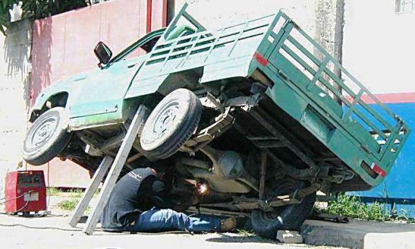

Name:  Sketchy Jack Stands.jpg

I thrust those 4x4's more than that scissor jake
