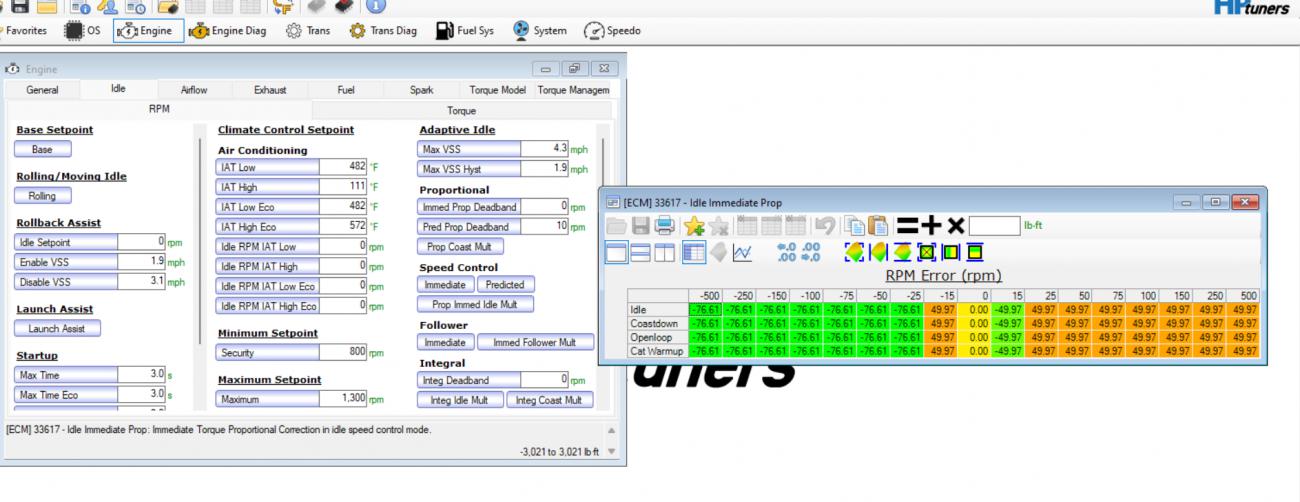

you can do it by adjusting the Idle speed control to fight itself and constantly search for idle. It does this by rapidly advancing and retarding the timing. See the below screenshot. While you may fool a couple of people, most car guys will tell right away its fake, and others will just think something is wrong with your car.
