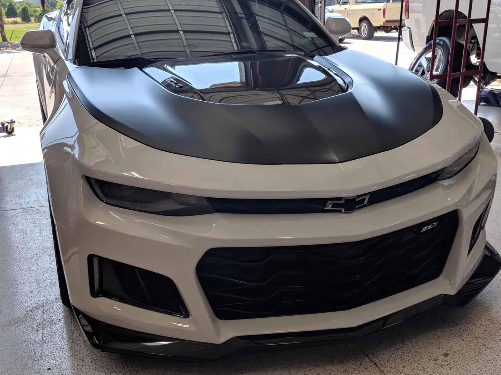

Anyone on here after full Bolton’s immediately after have fan running 24/7 just normal driving... and throttle response is terrible ... gotta press on it 50% just to get it to move. Also have apparently a failed high side from factory so can’t run e85 and 93 apparently loses pressure too. Full Bolton’s kooks 2in , 2.3 upper, 102mm throttle body and weapon x intake
