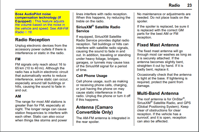

I do not have the Bose system but found this on the MyLink Infotainment System Guide, might be able to turn it off if you have this option or a similar option for ambient noise.

Yes I do have that (in all my cars actually) it increases volume based on how fast you go.
It could be the same technology though
Volume changes based on the position of the top.
I’ll have to try turning that off to see if it makes a difference
Thanks for the good idea
