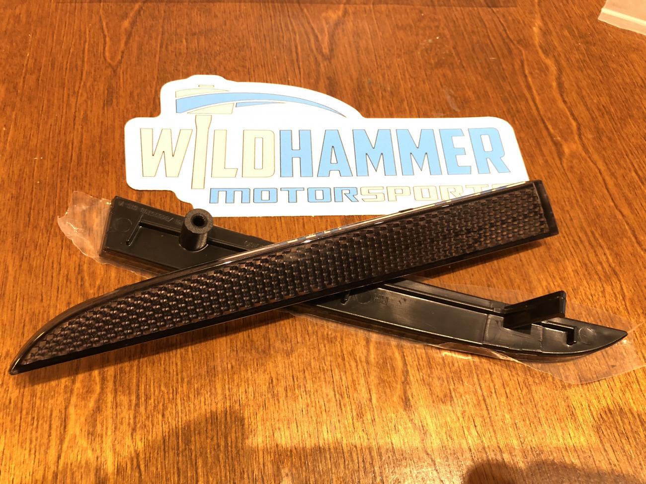

I haven't checked yet, but how do they come off? I ordered some black ones. Just wondering if they are easy to get out

I got these https://wildhammermotorsports.com/ca...EaAqipEALw_wcB

Got mine 👍👍
