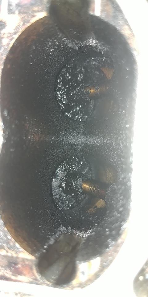

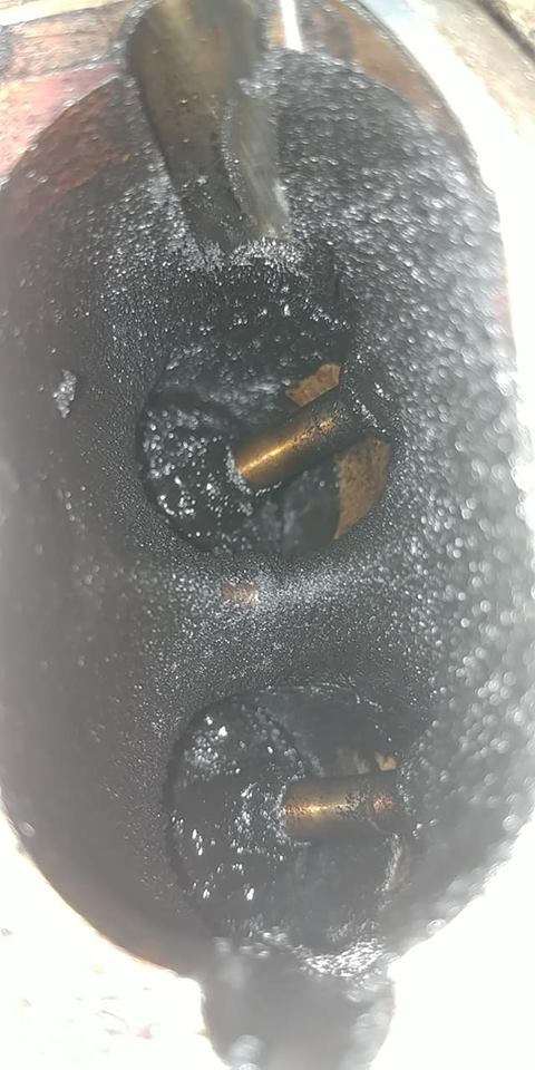

Just a reminder to everyone how cool direct injection is.
Even with a catch can to catch the oils you will still be getting some dirty carbon air which will eventually lead to this build up.
Either screw over bambie and vent to atmoshphere or get yourself port injection. It isn't just German cars that have this problem, I gaurantee at 50-70k miles all direct injection cars that don't also run port injection and use a oem type pcv system will be pulling your intake manifolds and having walnut blasting done to your heads.
My weekend over here pulling oem intake manifold, bottom manifold with tumble flap valve assembly (probably going to remove those as its a boosted car and I don't let it get vacuum often lol), having to reseal and clean injectors and pay someone to come out and walnut blast the intake ports clean again
For you guys with a dry sump system, yes this applies to you also. My R8 V10 here is dry sump also....

Originally Posted by Turbo_RORO View Post
Catch can and Port Injection.
bingo
This is no joke guys
Audi quoted 1400-1700 to clean out
highest quote from a independt shop was $2500
lowest quote $1200
I did all the labor pulling apart and have a porsche guy coming to clean it this weekend $200, even still will need all new injctor seals thats $40 per injector x 10......
Direct inject is cool till this happens. I'll say Ford is smart for them keeping port inject when going direct inject, and ZR1 vette won't have a issue either but everyone else get ready for some maintaince
