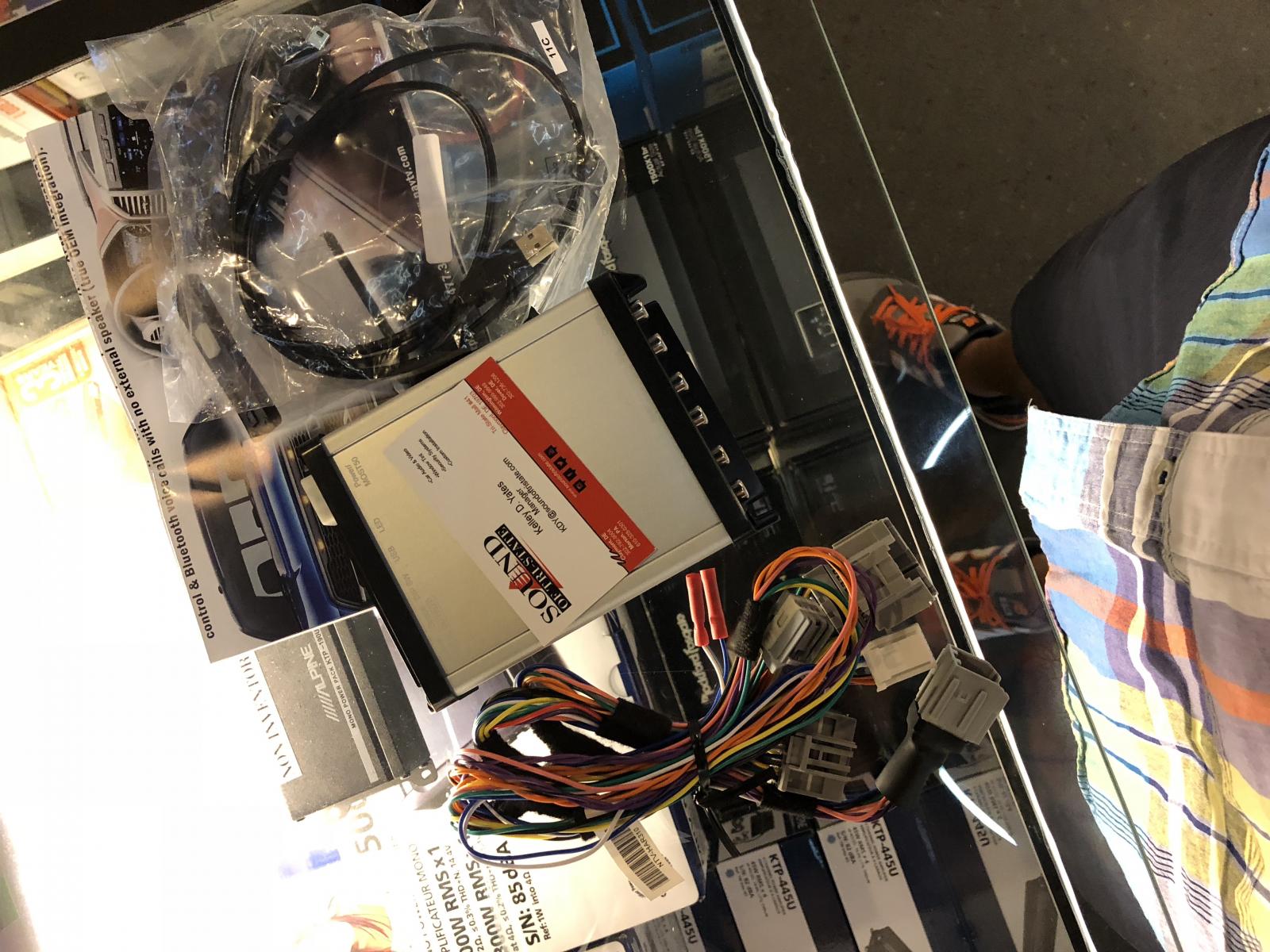

So I went down and picked my gm-650 up today. I am looking forward to installing it with my xmd jl1000X. (5CH amp) and and BIT TEN D. still have a Few more parts to order before I will start the install. but here a pic it the unit and a plug from the guy that I got from (not sure if I can plug him or not but if not plz let me know)Name:  FpqATDrXRaGeKe5VDbOxXw.jpg
