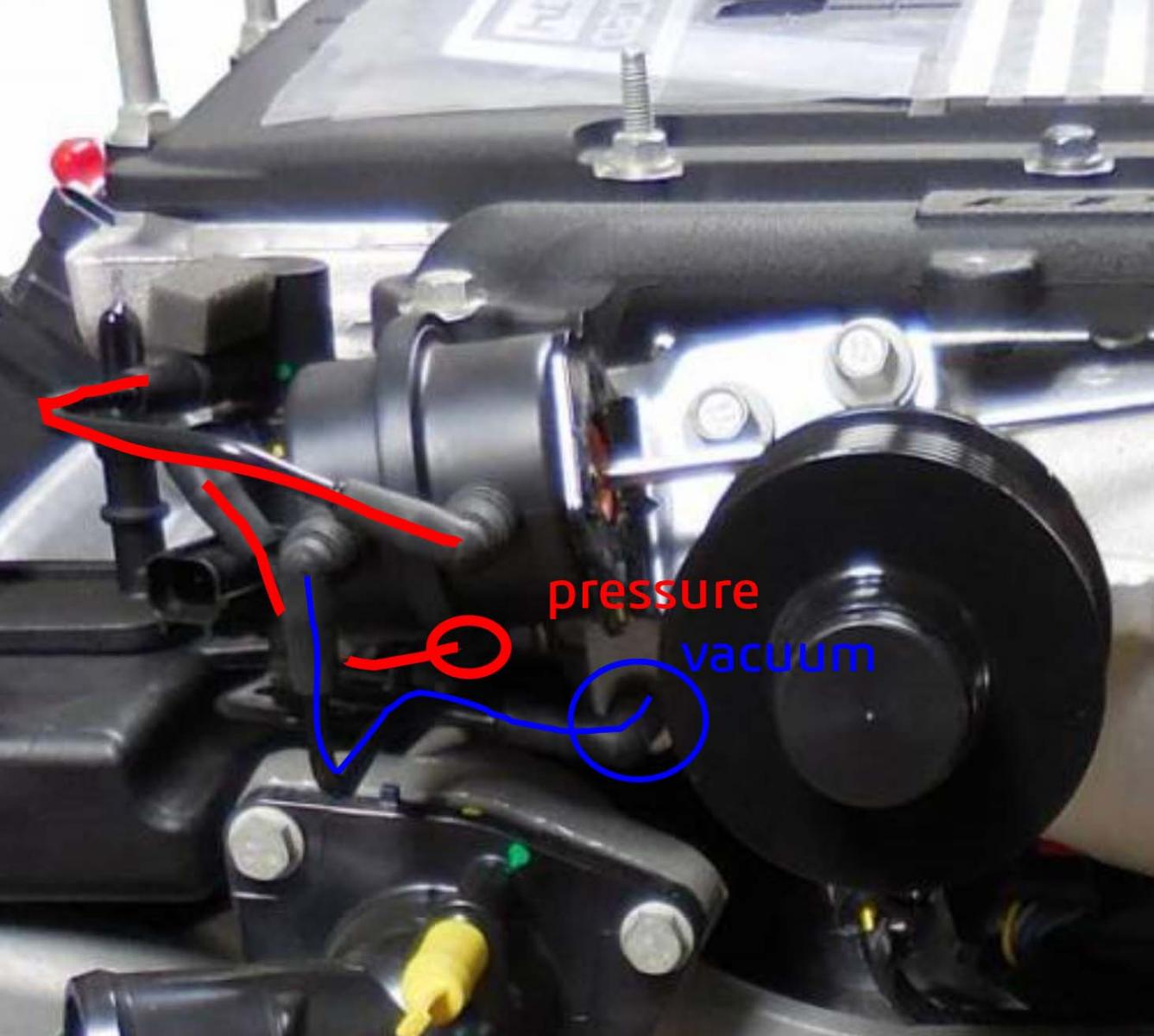

Where can read boost on a LT4 Camaro (2018 ZL1/1LE)? I tried the bypass, but there's no boost there. This is while on the dyno.

there is a pressure port tucked under the inlet, it feeds the solenoid/bypass actuator, to constantly monitor manifold pressure you need to reference before the solenoid

Posts: 47
Thank you!!!!
